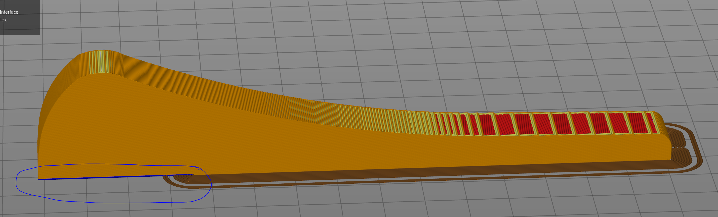

Hi All, im quite new to Sketchup and 3D Printing.
Now my model looks great in sketchup, looks level and all.
but Slic3r detects overhang on places i didnt expect.
can anyone help?

and slic3r screenshot
Try to make it a Solid Group, as it should for 3D printing
Thank you for your reply @mihai.s. Unfortunately the same error is still there

Try this one. Is it any different?
Thank you sir, that solved the problem.

It was not aligned with the main axes and of course, it was not a Solid Group.
