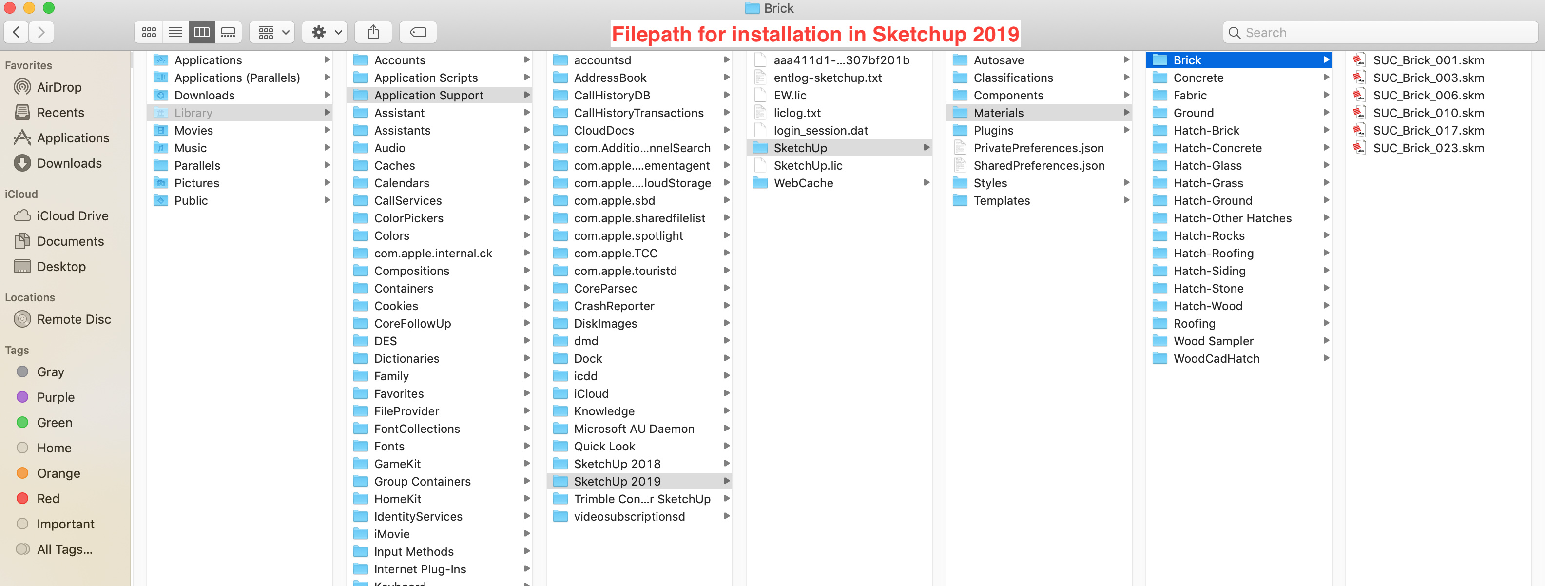

The materials browser works fine with the native materials supplied with SketchUp Pro 2019. However, I imported a pile of materials from SketchUp to Layout from Matt Donley. When I select one of these imported materials for the first time in a model, it works fine. However after that whatever imported material is selected, only the originally selected material will be applied. The native material still work fine. This was a problem in SU 2018 as well. I don’t remember it happening in earlier versions. Attached are some screen shots of my files so you can see the path and file names. Many ideas? Thanks.
