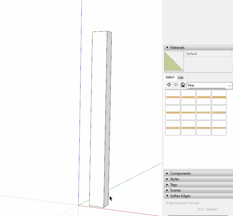

best approach for nearly all modeling is to apply the materials to the faces. It doesn’t have to take a lot of time to do and it gives you better results and makes the model easier to work with as you move ahead.
As always @DaveR, you do a great job guiding us wayward folks back to the straight and narrow - which is much appreciated. And when SU2022 is released, the migration of my materials will be more straightforward now I know where they are. Cheers!
Thanks Dave for the very informative GIF. I knew about applying texture to the faces rather then the component. Its the last couple of steps that I wasent aware of where you selected all faces, then sampled the applied textured on the first face and applied it to all faces. A real time saver. Now all I need is to snap some photos on my next trip to my hardwood supplier and build up by wood texture library.
