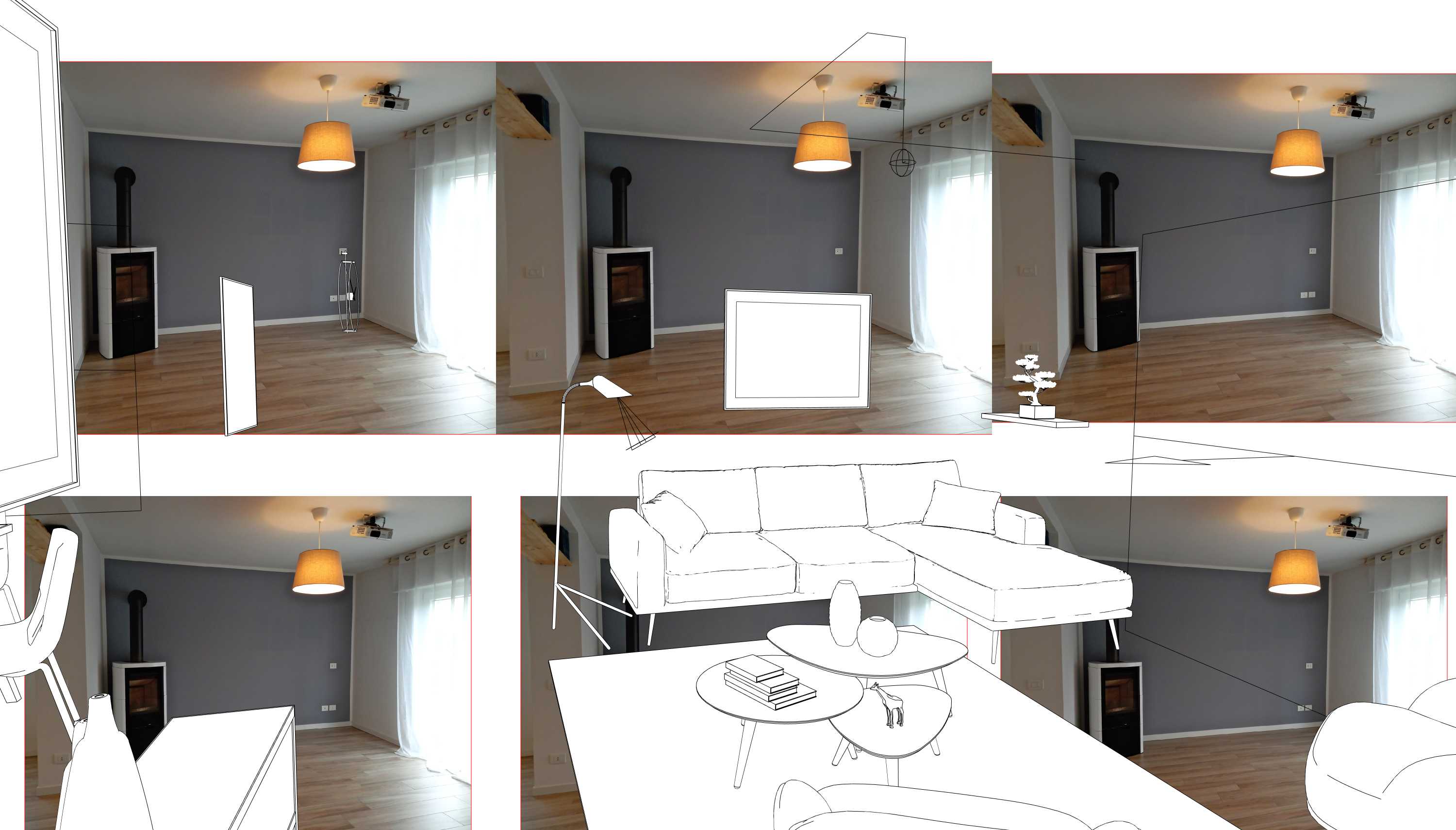

in the italian forum someone had find out there is a problem in SketchUp 2024 that causes a wrong exportation in jpg format. As you can see in the attached image the matched photo is tiled…with non sense effect.

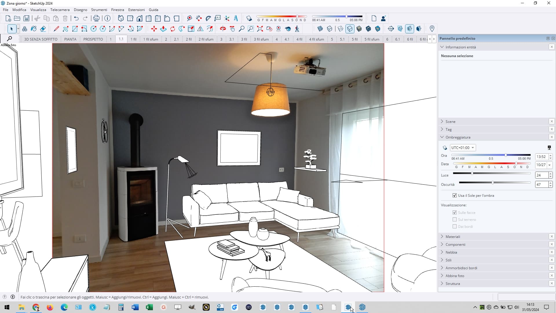

Here is the SketchUp matched photo…
pretty sure I’ve seen this around here, it was a DX12 issue (new engine)
reverting to the old engine should allow a normal export.

This problem happens on Mac as well. We still haven’t fixed it. It only happens with the new graphics engine, and with scenes that have particular images in them. Ones from Match Photo or Diffusion for example.
Is pixel dimension a part of it? Years ago I discovered a limit and thereafter made a habit of downsampling my images to screen resolution before using them for Match Photo. Right now all my old Match Photo files I’ve tested with new graphics engine turned on are OK.
It relates to a tiling issue that has shown up in other ways. Having a smaller image export, and also turning off antialiasing in the export options, are both likely to help.
