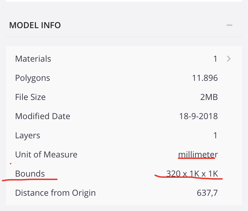

Look for this bit of info: “bounds”, it will tell you (more or less) the size of an object

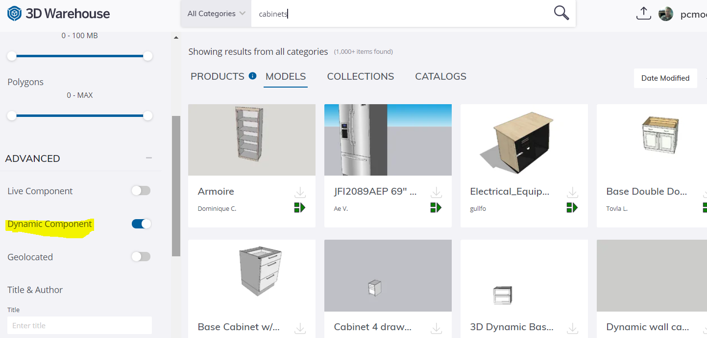

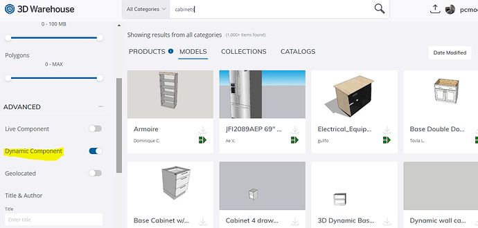

Some are dynamic, then you can plug in the sizes you want
then if you want use
and then modify any area not covered with the DC

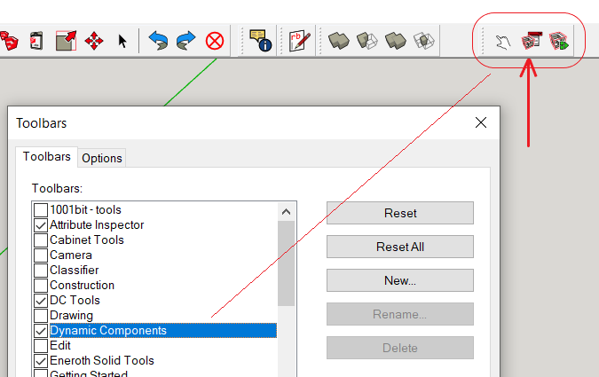

You can excess options if available (depends on author) via the toolbar or right click menu.
select “View”, toolbars
Capture
Again, depending on the author, you may be able to scale, input metric, however, since you have Pro, you can set the attributes to suit.
