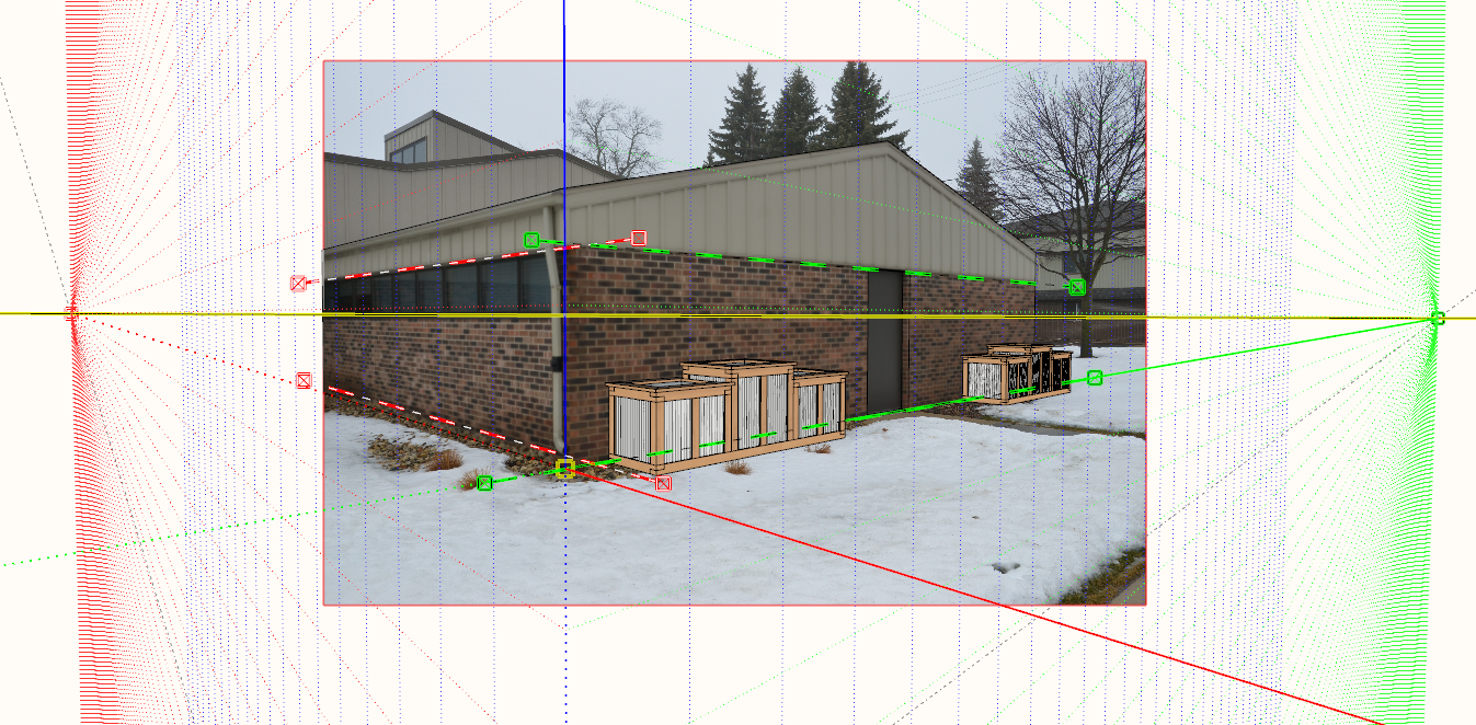

It’s still not an appropriate image for Match Photo but maybe it’s close enough. As I wrote yesterday, you need to have lines in the image that run off to two vanishing points on the horizon. You don’t seem to have that in this image, either.
You can see how the vanishing point thing works with this image.
