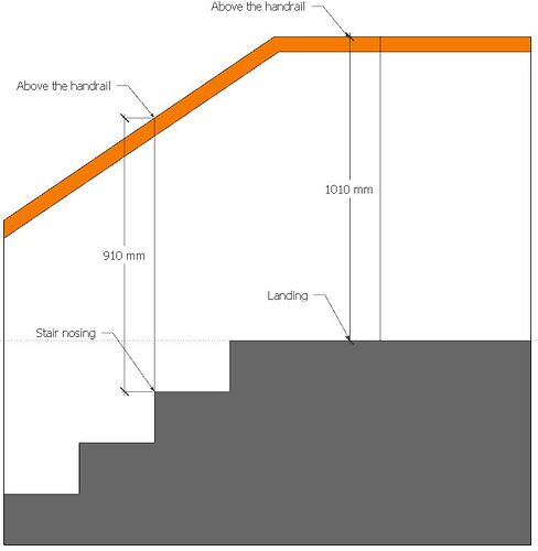

Hello, your Plugin unfortunately does not apply the manufacturing standards, which is a shame.
Height 910mm from the stair nosing above the ramp and 1010mm from the landing above the ramp.
pity.

hello Majid, sorry to have aufencé but I am French and indeed I use the translation :+1:.
I’m in the business and it’s just to help you develop Maj Stair.
I am attaching a picture to you.

the coast at the crawl and at the right are not the same.
I tested several tools for the handrail and none respect this rule.
The sizing of a stair railing standards are:
Height of the handrail on the ramp in the horizontal section: 1000 mm
Height of the handrail on the ramp inclined portion: 900 mm
Distance between the bars on stair railings: 110 mm
Distance between smooth on staircase railing: 180 mm

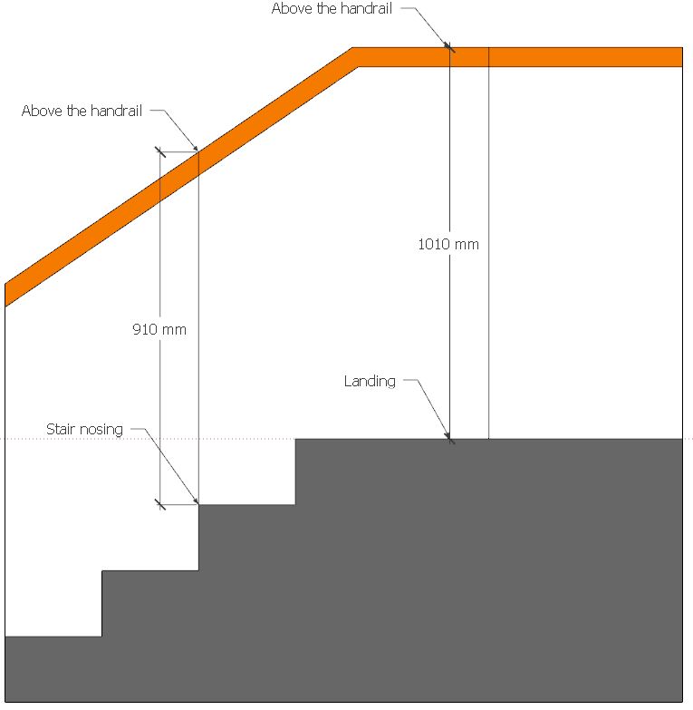

Rail Height is from floor to above of the handrail or bottom of the handrail or middle of the handrail? For this plugin, I consider from floor to bottom of the handrail. It is clear in the picture I sent to you. In next version I will consider rail height till middle of handrail for all types of rails.
Always I forget I am living in Lilliput. I make attached picture especially for you.

Thank you for the second image. A 200cm (two meter) railing is extremely high - above to top of my head!

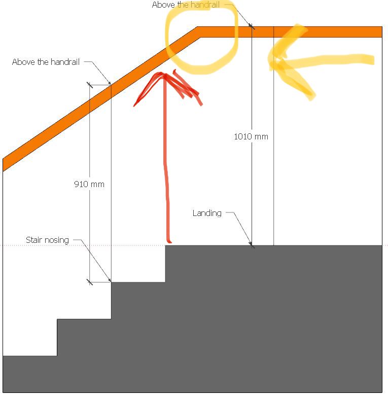

Is this the change you are wishing for? Consistent rail height measured from stair nose, rail ramp must coincide vertically with top stair?
Excuse my poor diagram, I’m on my phone.
Please wait for the “MAJ Rail” new version. It will publish after few days. Type C added to the new version. In all types, height will be from floor to middle of the handrail.
In inches the min. height at a landing or other walking surface is 42". For the stairs it is 34"-38", as long as it is a conforming handrail (correct cross-section) serving as a guard rail.
Yes that’s it, but apparently too complicated to do.
I have no sketchup plugin capable of doing this, same style builder 3.

Hello;
The photo is already there since yesterday.
It is the difference in height between the ramp of the staircase and to the right of the landing that does not work.
there is already a “fence maker” that does the same thing as you.

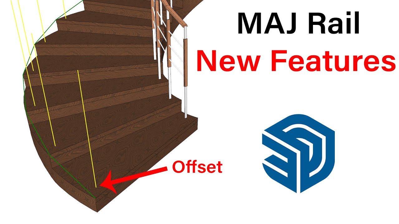

MAJ Rail Version 0.0.2 published. Please let me know your idea about it. To show probably problems please use photos from the extension.
The following video is a good introduction to this extension.
