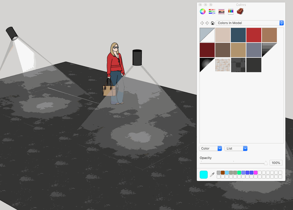

I can now make a cone of light. brilliant. you guys were fab.
even if i repeat the whole processes importing a new translucent PNG and creating new cones, any edit i make happens on all the previous cones. Sometime even on a new import the original colour pops in.
when i duplicate the texture i cant edit it.
and sometimes becasue the texture in the model window goes left to right instead of up and down, the gradient runs in stages around the cone. weird.
any chance of a dummies guide to creating a series of cones, translucent, within a model which i can hide depending on different scenes. so the cones would need to exist in the same place (as in from the same light).

Here is a simple and reliable way to create colorized textures that will stick. Open two SketchUp windows simultaneously and use copy paste to move the edited color cones into a new file one by one. I start with your file (I selected and right click - hide - the circle edge at the bottom first) then I apply the gradient texture to the outside and inside of the cone making sure the gradient on the sampled surface is tall enough for the whole cone. Now I have a gradient cone, I open the materials pallet and find the material, then I right click and choose edit. I use the color wheel to edit color but you could use the RGB sliders to match Rosco or LEE colors, or the crayon color swatches. Anyway I adjust the texture and click close in the bottom of the materials pallet. Now I have colorized cone that is NOT a component, that’s important, triple click to select it all and copy it to the clipboard. Then click into a second open SketchUp file and paste the cone, it is imported with it’s adjustments saved as a unique texture in the new file. Go back to the original file and repeat the steps to edit the texture again choosing a new color, then close the editor and copy paste this new cone into the new file, it also is imported with its new color adjustment as a new texture. Rinse and repeat as necessary. It’s important that the cone be raw geometry at this point as if it’s a component it will be imported as an instance each time and will not retain the color information, you will make components of each as the next step. Save the original cone file somewhere handy as a factory for making new color cones in the future.

I was able to get this from your uploaded file, in one SU window.
Move/Copy all four of your blue cones to a new position. Select all four, R click and Make Unique, as I suggested earlier.
Create a red gradient by colouring a copy of the existing one red, and sizing it appropriately.
Sample the red texture on the rectangle using the paintBrush tool (shortcut b) plus Command. Release the Command key.
Open one of the new cones for editing, select all, then click B again for the
paintbrush tool again. Click on the surface of the cone.
Done.
Tag the cones as needed - for example, use a Blue tag for the blue cones, Red tag for the red cones.
Here’s the result. Couldn’t remember what version of SU you were using so saved back to v2017.
Lighting conesJWM.skp (1.1 MB)

Thanks for this plan, I get stuck with the changing of the gradient (perhaps this tallys with endlessfix mac issues??).
I can copy the cones no problem.
I can copy the gradient no problem.
But what is the step to change the gradient colour to red? In the Colours tab, Colours in model, the new gradient isnt shown so not sure how to change the colour. If I duplicate the original it changes them all.
What steps do you take?
Thank you.
I opened Colours - named in the colour picker, and chose Red. Then selected the second copy gradient in Colours in model, chose Edit, and applied the red colour to the gradient. I had to fiddle about a bit with Texture/Position to get the gradient light at the bottom.
You could do it more easily, I think, using Duplicate on the gradient blue colour then colouring that red, before applying that material to the second collection of cones.
