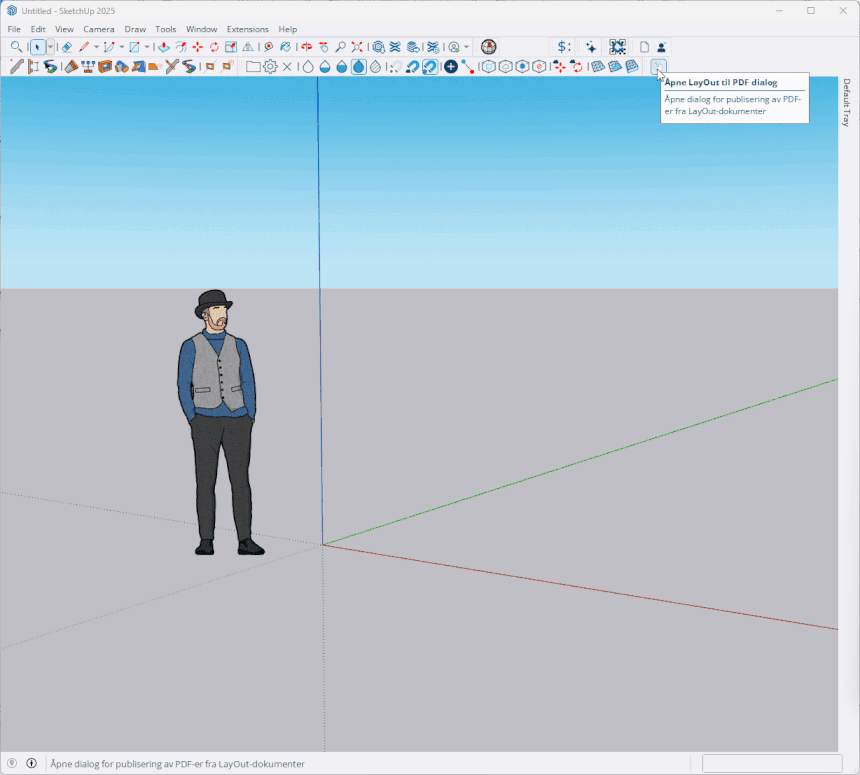

While version 3 is in review in the queue in the Extension Warehouse, I currently skipped the page/sheet set and focused on translations:)
besides the ones SketchUp support, added Dutch and Norsk.
SketchUp
mw_lay_out_to_pdf.rbz (715,8 KB)
