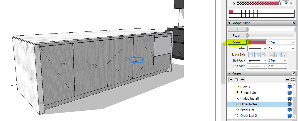

Hello Sketchup team,
Sometimes I would like to turn this stroke off when labeling.
Would you please consider this?
If you mean the Leader line then it cannot be turned off as such as far as I know. However, if you click into the the label object and have the Leader line selected you can give it a white colour (or any colour to match your paper space). Or, another way is to select the leader line and make it’s colour 100% transparent.
@shawb’s suggestion to make the leader color transparent is probably the best solution because it allows the label to still be connected.
@DaveR I agree. @shawb Thank you.
