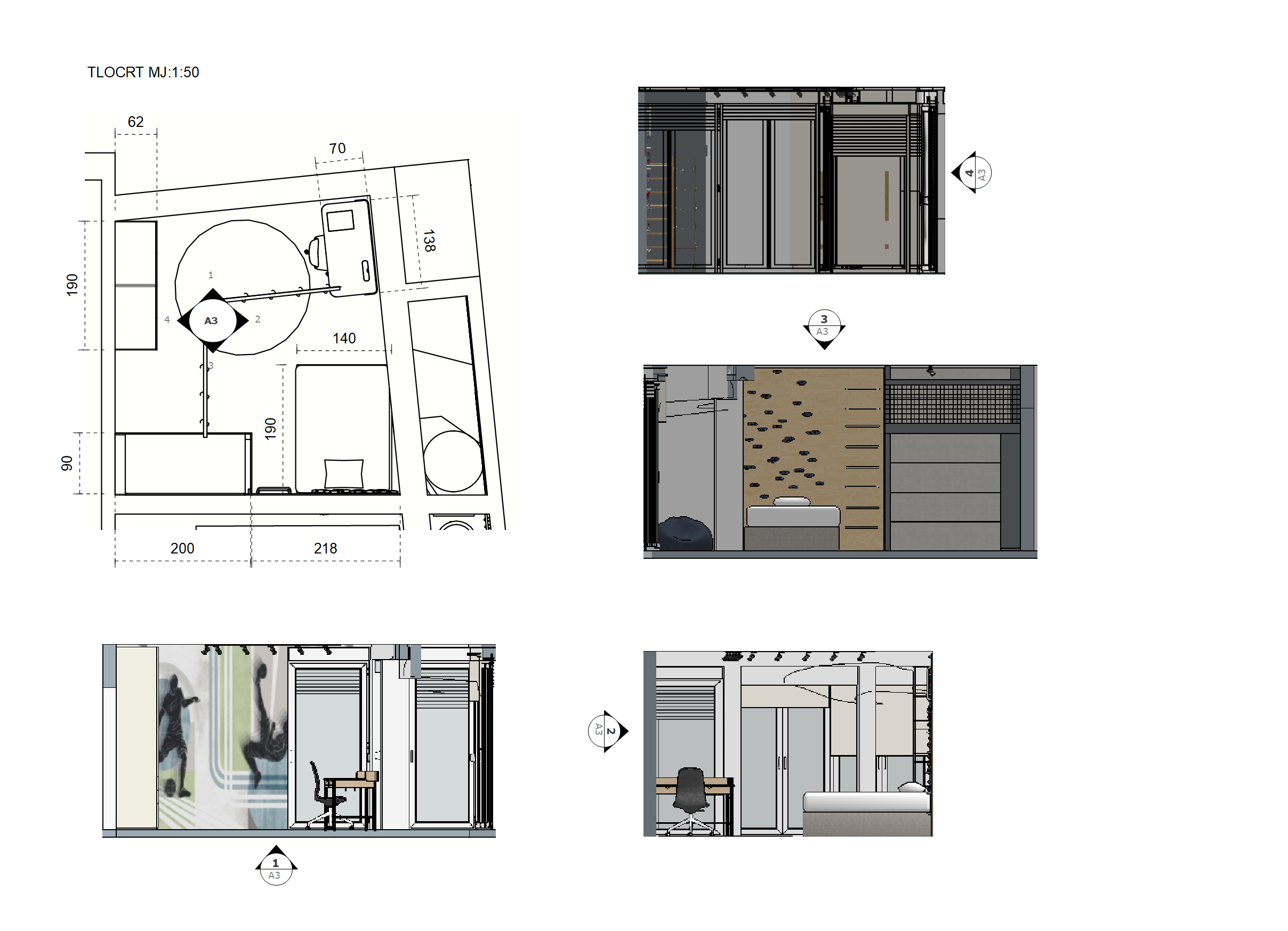

Hi there,I have problem with exporting my elevation views to pdf.

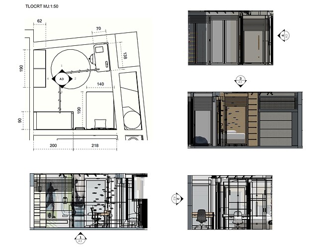

Pic.1 one is showing page in Layout and pic.2 is showing it in pdf. when exported. Not sure why is showing elevations of all walls when I obviously set camera to show only one wall.
Any advice on how to fix this issue?
Are you exploiting the clipping “bug” to produce your interior elevations? Clipping and Hybrid or Vector rendering do not work together so either create your views using section planes or use only Raster rendering for your interior elevation views. Also check in Document Setup>Rendering that you don’t have Output Override turned on.

I had the Output Override turned on for some reason so I exported it this morning and it worked just fine.
