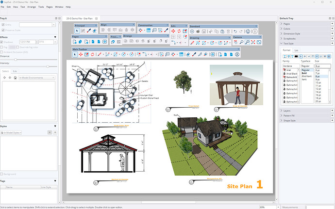

This image shows all the available toolbars and coupled with the Text Inspector we believe it provided most users with the tools they would need.
We had attempted to allow users to add all options that we have icons for but it looks like more folks rely on tools we do not have icons and would like a way to establish standalone instances of our tools.
We will be working to provide the missing tools moving forward and that will most likely look like creating icons for all available tools.
