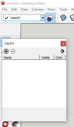

Just downloaded Make 2015. Opened a new file and set up 3 new layers: Imported a .jpg into one of the layers then saved the file. On re-opening the file all the layers were missing, from the manager, including layer zero, but they are still in the layer display window. I unloaded Sketchup and cleaned the registry (does not uninstall cleanly), then reinstalled which fixed the problem. However this is unsatisfactory in the long term as it keeps occurring and reloading is very time consuming. OS is windows 10 build 10130 but I have the same problem with windows 7. Restting the workspace does not solve the problem.

The display window is the small box with the down arrow at the side. The manager is the icon that shows multiple sheets of paper stacked. The manager box is completely blank and does not display anything including layer zero, which in theory is a system layer and not removable. Without the manager displaying, you cannot hide a layer or decide which should be the default layer.

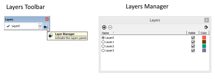

Your screenshots show the same file? If you open the layer window from the toolbar, there are no layers and if you open it from the window menu, they are shown?

There are two different âLayersâ windows (unfortunately) that do not have the same options.
Yes, same file and yes it does show correctly if you open it from the toolbar.
