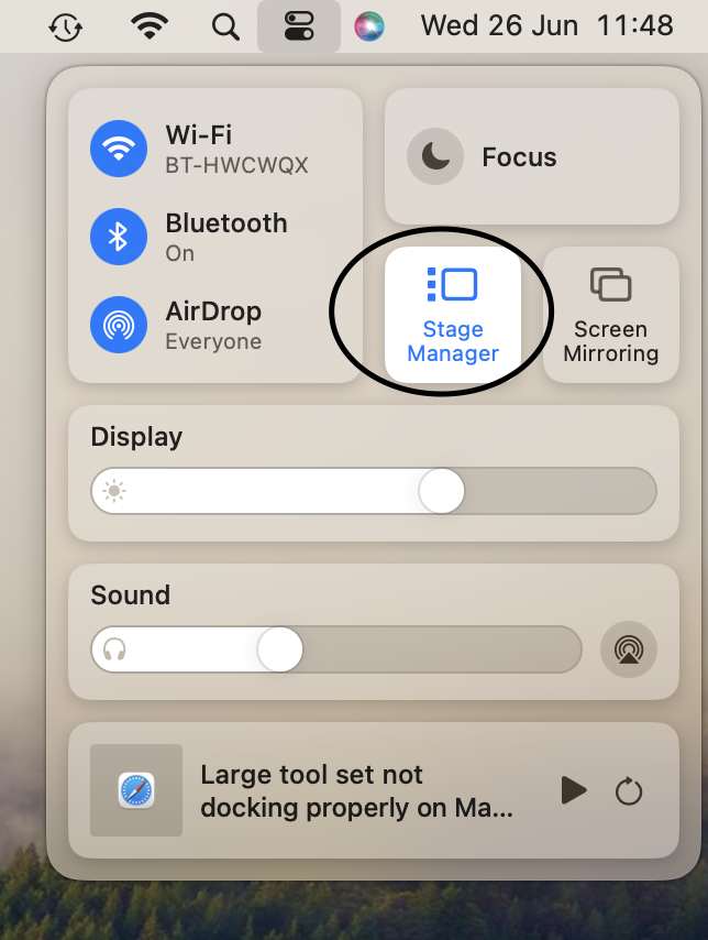

Have you got Stage Manager turned on? If so turn it off and that will allow you to position the toolbar to the left. If that’s the case and it works you can turn the Stage Manager on again and the toolbar will stay in place until you quit Sketchup when, after reopening, the toolbox will once again behave as before.
Thank you, that was it.
