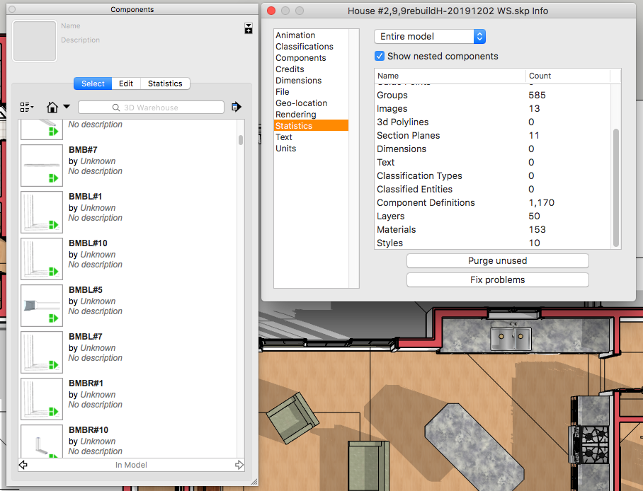

I also don’t quite get the rules behind the palette not showing all of the components that are in model (is it context level sensitive or something?) until you check ā€œexpand,ā€ and then there’s just too much information. It’s not just my components, but all the third party components and their subcomponents which are especially explosive in number with dynamic components. I have to wade through all these bits to find my stuff.
Screen Shot 2019-12-20 at 12.44.46 PM
Because of this, I’m trying to move toward saving my project components in a local collection for the project and keep that collection open instead of the In Model collection.
Yeah. With nested components like you’re using, it take expanding to get them all to show.
I don’t know what components you’re using but it might be that they could stand some simplification.
Depending on the situation, maybe it would be easier to access the components from a local collection instead of the In Model.
