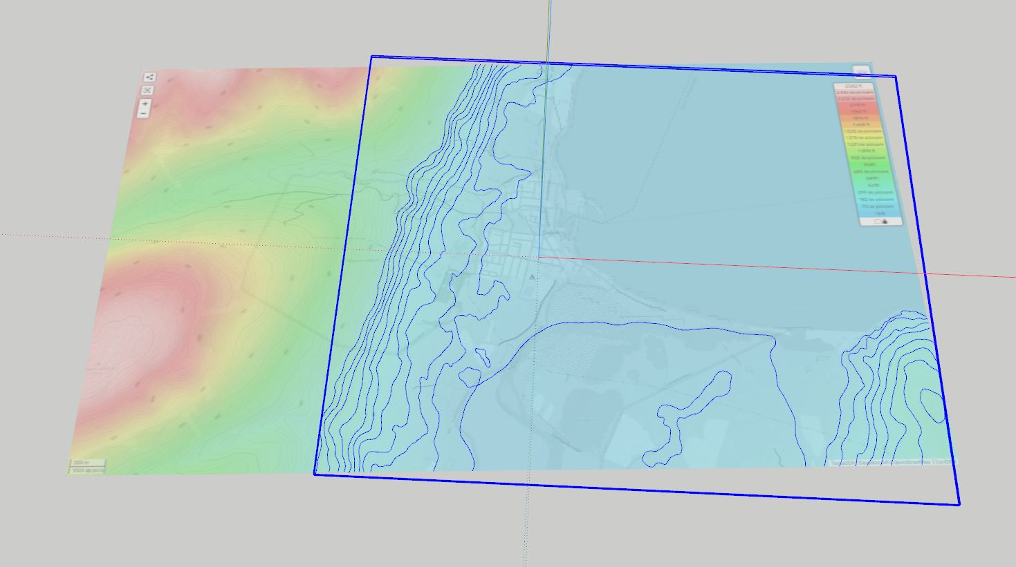

I tested it with a random location marked by the orange pin here:
Here’s the 3D mesh after import.
I suppose there might be parts of Iceland for which terrain data is available but there’s at least some.
Hi Dave and thank you for the replay! I think I am doing everything correctly, I have also tested other places in Iceland like for example Reykjavík and another town called Akureyri and then it workes fine but the location I need it for is a part of the town Dalvík and there it always comes out flat, also tested for another small town and it came out flat aswell. I have tested both Bing and Digital Globe.
I see what you mean. It does look like there’s no terrain data for that part of Iceland right now. I took an area around the pin here because it looks like there should be some terrain but even the 3D mesh is flat…

There are some pretty big holes in the terrain data around Iceland, it’s very area-specific though (e.g. Dalvik and the whole valley going inland is missing, but the nearby settlements of Arskogssandur & Hrisey have good coverage.
