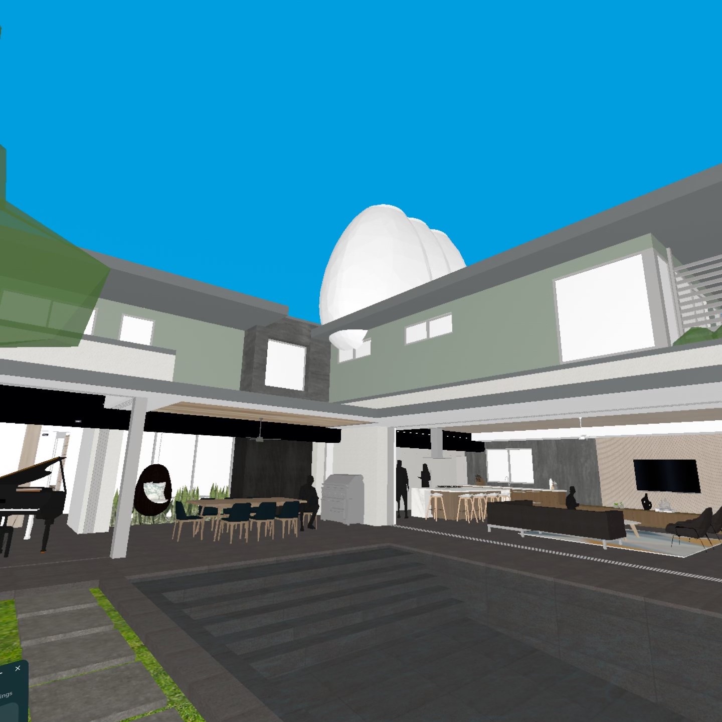

I don’t know why but when I use the Sketchup Viewer for Meta Quest on my Quest 3, there are a lot of jagged lines. It appears that it is missing an anti-aliasing filter. When I view the same model using the Sketchup Viewer for VR with Air Link to my PC the same views look way better. Attaching an example of the problem.

Hi Aris,
I’m not comfortable sharing the model but you can also see the problem in the startup scene you see when launching Sketchup for Quest. Look at this picture around the window frame there are a lot of jagged lines.
Thank you for following up on this.
We are aware of the issue and will look into ways to improve.
Thank you for the continued interest and feedback.
Best,
Aris
