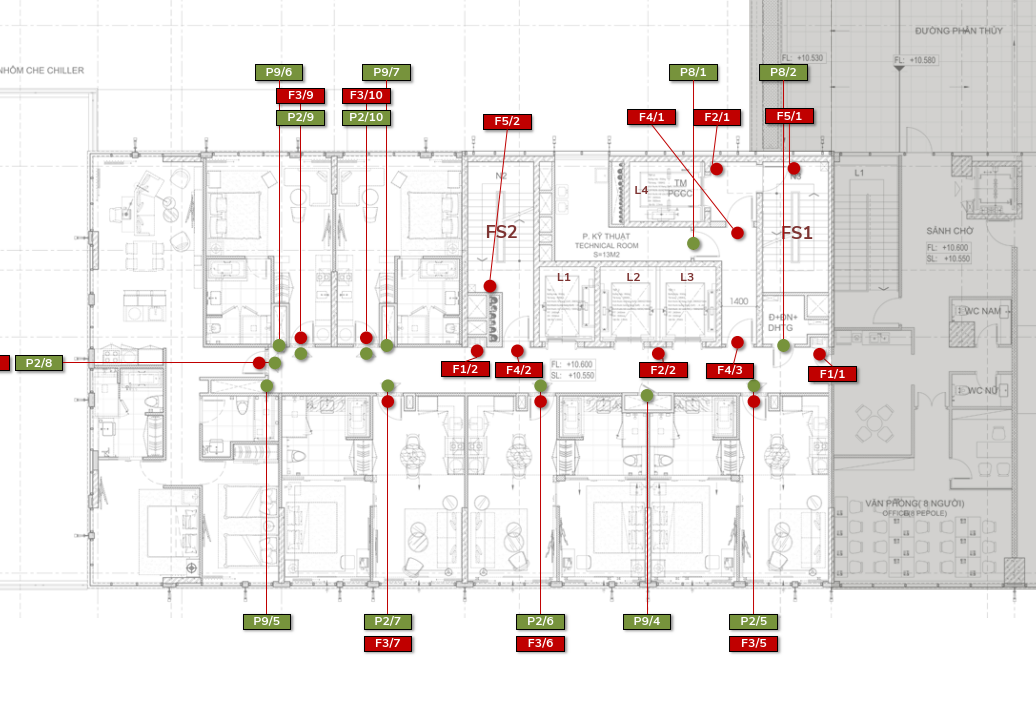

One of the reasons I do not use LAYOUT frequently is its inability to globally update contents within the document….
Having the equivalent of ā€œcomponentsā€ within LO would be one major feature that would address that limitation…
even better if it worked in the same fundamental way as they do in SU. [with similar interface]
Extending that principle, if Live Components [or Dynamic Components] were also an integral 2D tool in LO, it would be similar to 2d parametric objects as in Visio
At it simplest, I am think of a tool for managing symbols [ eg electrical / lighting symbols, updating one instance updates them all]
As I noted in my posts… just having the standard component capacity in LO would be a major benefit that I would prioritize over live components generally.
Similarly, ā€œfind and Replaceā€ is a very basic tool for efficiently editing large data content… [essentially what a component allows] but all general text also desperately needs this capability
Eg [door tags, windows tags, product codes, editing repeated text…
Sample below of tags for interior signage [ I can easily change the sign code from say F4/1 to W4/1 thoughout the document in Powerpoint [10 floors / pages] in one action
Impossible in LO – would have to manually select everyone
