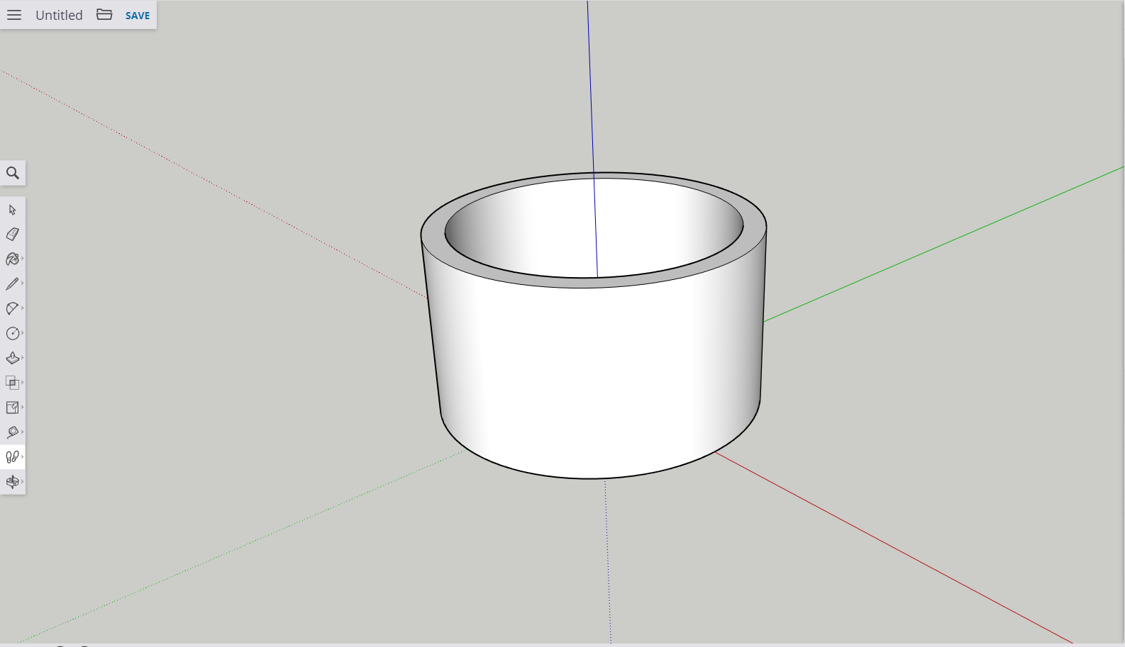

As the title says. Am I doing something fundamentally wrong or is this program just extremely limited?
This is what it currently looks like https://i.gyazo.com/e0986cd2713548baaeb4bcd109f70a6c.png
I’d have to say it’s you doing something fundamentally wrong. Why are you drawing a cylinder if you want a cone? Why not just draw a cone?
I’m in need of very specific measurements, thickness of the cone, the hole at the top and width at the bottom. Creating a cylinder seemed to be the way to go and trying to use a tool to push the cylinder into a cone seemed to be the way to go but I guess not. I’m aware of the follow me tool, but how do I draw the first piece of the cone? When I do it it’s not possible to use the follow me on it.

So not really a cone? Can you show us what it is you are trying to model? I’m sure it isn’t impossible to model but you haven’t given us enough to go on.
@Box Yeah I was thinking of doing it like you did in the destktop version. Thanks a bunch!
@DaveR Yes not really a cone as said in the title. Cone shaped cylinder pretty much. Exactly what Box illustrated.
So then you’re all set? FWIW, since you don’t need it to be closed like a cone, you actually could start with a cylinder and use the Move tool to move cardinal points to resize the edges. Hover over the edge of the circle and find a place where the edge does not show as selected. Then click and move the cursor the required distance. You can type a precise distance if needed.
