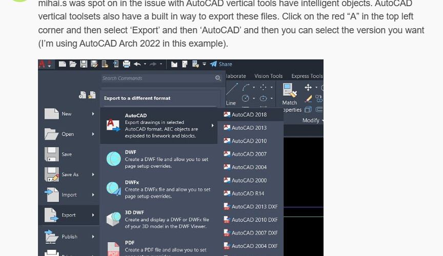

After I sent my previous email, I noticed SU had flagged this discussion up, wonder if the graphic snippet would be useful to my friend when choosing the export mode:
