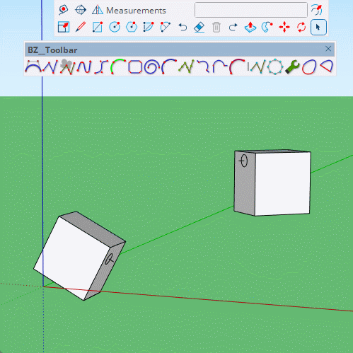

How would you draw/model the cable part for a extension cord?
I need to make a cord that comes from a extension cord and connects to the plug. I tried the clothworks, but it goes through the floor. I wish i could pin point the two ends and somehow it all connects. I tried using the freehand line, but its hard to draw it perfectly from point A to point B. Taking any suggestions!!
You need to make the floor a ‘collider’. Search YouTube for tutorials about basics of ClothWorks.
Or watch the videos on ClothWorks page - ClothWorks | SketchUcation
There are various tools that can give you a result, which you use and how very much depends on what you need it to do.
This is a simple follow me with a bezier curve. As a bezier it can be manipulated as much as you want to a specific shape.
GIF 21-11-2025 11-52-01 PM
Another option to consider, no extensions, simply understanding the tools available.
You can use the line tool to create a path and the two point arc tool to round the corners and then follow me to finish.
GIF 22-11-2025 12-06-16 AM
Wow, i really didnt make it a collider. I thought i did, thats why i asked what is wrong! haha, thank you so much:)
yess!! i am trying this one out now! Thank you so much for the demonstration! Really helpful!:slight_smile:
