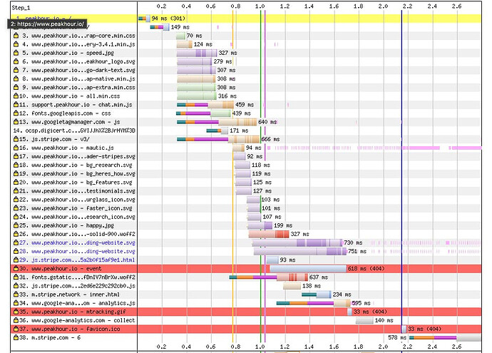

In web development, there’s a concept of a “Waterfall Test”, where the site is analyzed from the viewpoint of “which resources take the longest, and what’s dependent on what”:
I basically need to do a waterfall test on my Sketchup setup, so I can decide, for example, “OK, this extension adds 0.1 seconds, I don’t care” or “this one adds 3.2 seconds, and I only use it rarely so it should be disabled”. Right now, I have no way to see what’s “heavy” and what’s “light” and no way to compare that to their usefulness.
