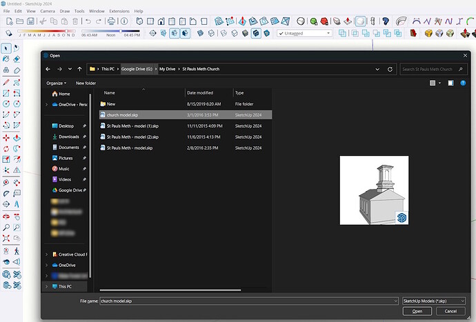

I just imported my drawings to my google drive - but I cant seem to be able to open them from there at my computer when I want to work on them. I can on my phone - it opens in the viewer - but not at a desktop. Anyone can help me solve this simple issue? The thumbnails also dont populate - probably a signal I need to correctly map the file path etc.

Do you have the Drive for Desktop installed on your PC? If not you’ll need this to allow Drive to act as just another folder on your PC. I have SU files on my Google Drive and I have ZERO issues in getting to them from either home or the office.
That was it! Thank you!
I knew it was something simple. I dont know much about computers…

Installing Drive for Desktop.
