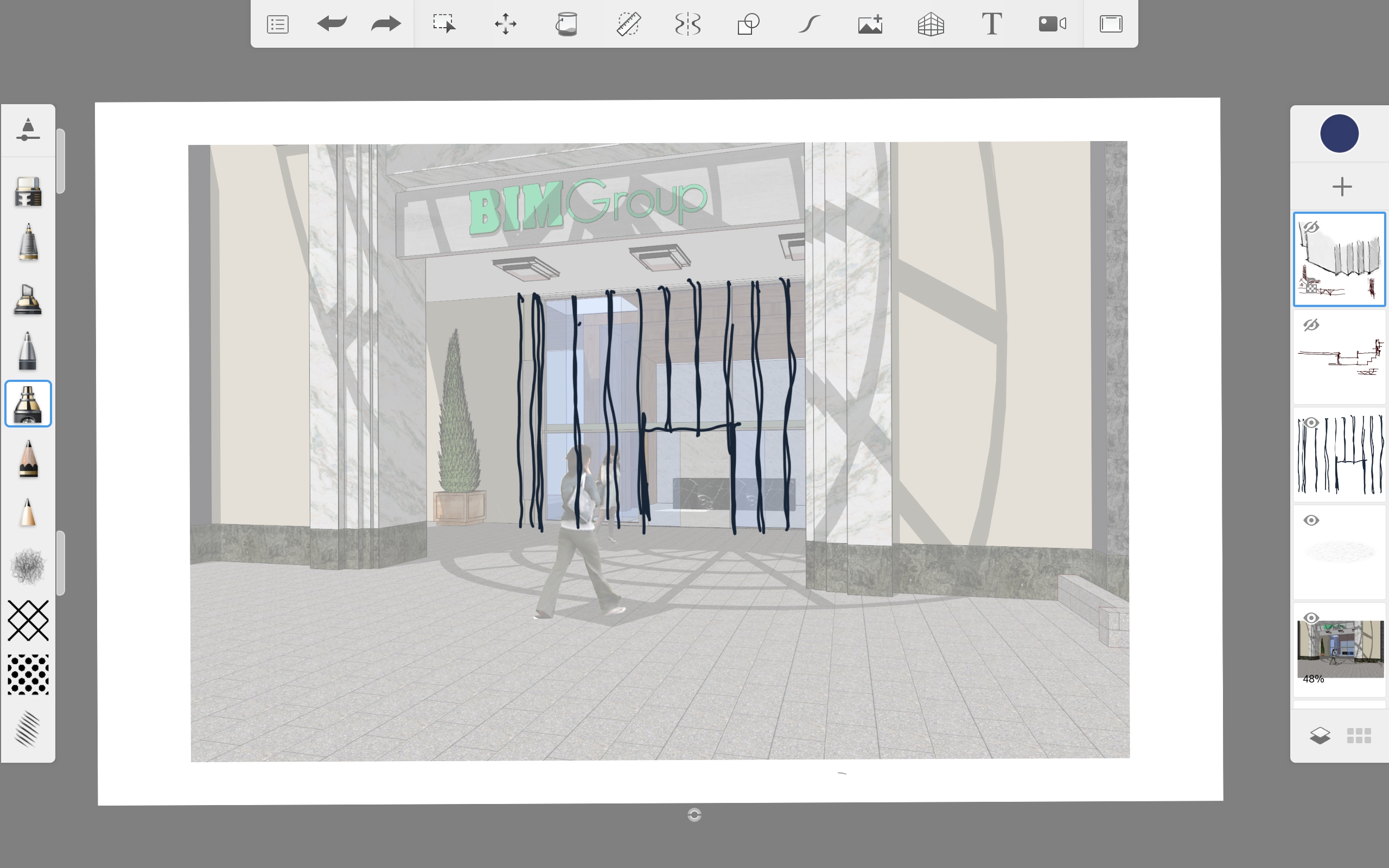

You can download GDRIVE TO your PC to have an sync copy of your gdrive on your PC… then you just use this folder on your PC and the GDRIVE software automatically backs it up to the Google online GDRIVE server… does not save space on your PC but makes your files available anywhere , e.g. you could look at them on your Android pad with Sketchup Viewer… ( as I do when wanting to hand sketch over models on my SAMSUNG
Not a great example but gives you an idea*
