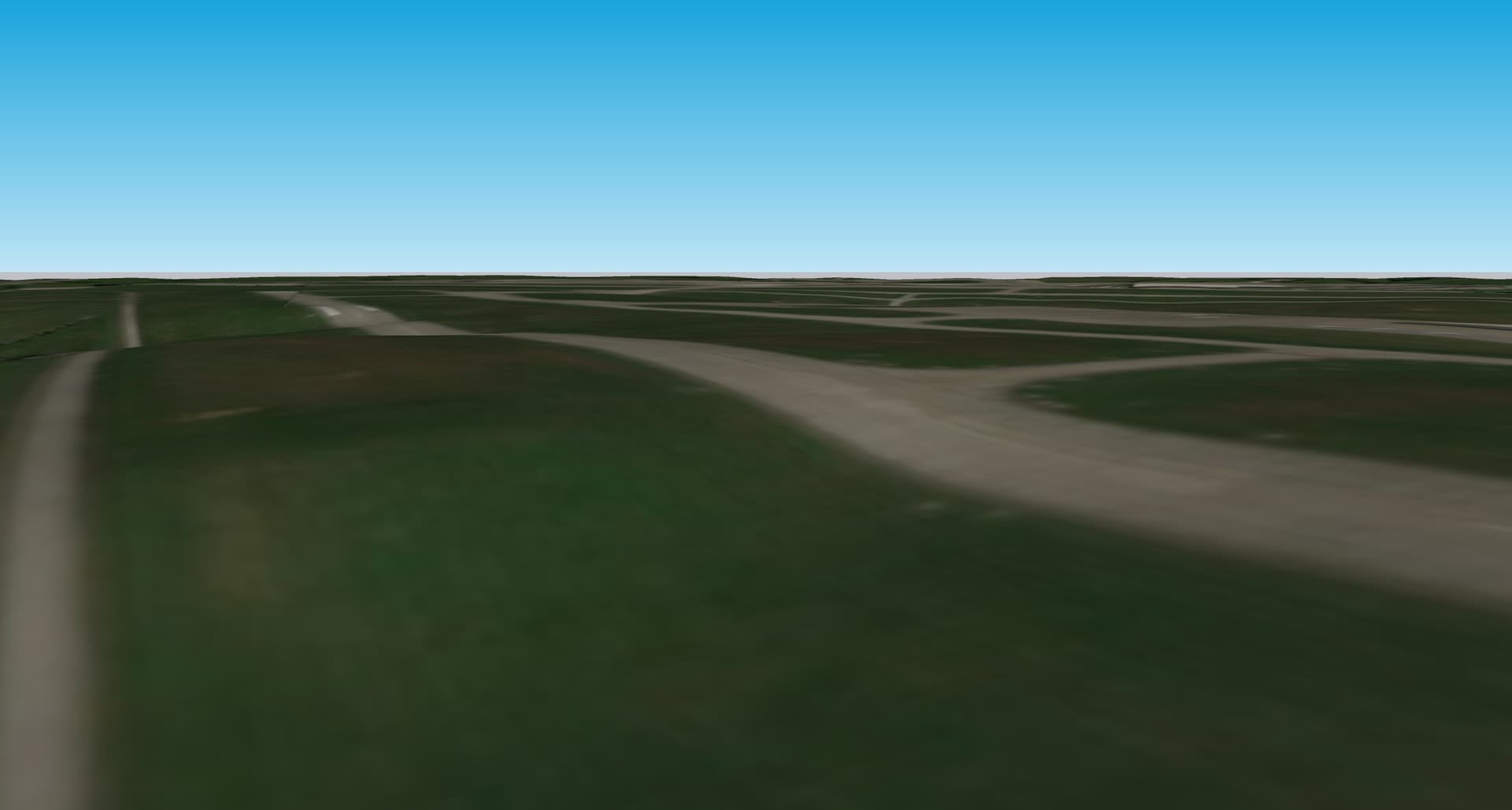

Hi everyone,
I’ve imported terrain from Digital Globe, and for whatever reason the Runway for this airport came in extremely “lumpy” and the elevations from one end to the other are pretty far off. I’m fairly familiar with the “smoove” tool, but it’s going to be really difficult to push and pull the terrain the entire length of the Runway to make it a gradual slope.
I need one end to be 30ft. higher than the other end with a gradual slope. Is the “Smoove” tool the only way to accomplish that? Or is there a way to draw a rectangle the same dimensions of the runway with that 30ft slope and then place the terrain on top of it somehow? Maybe purchasing Artisan would be better?
Any help is appreciated. Thanks.

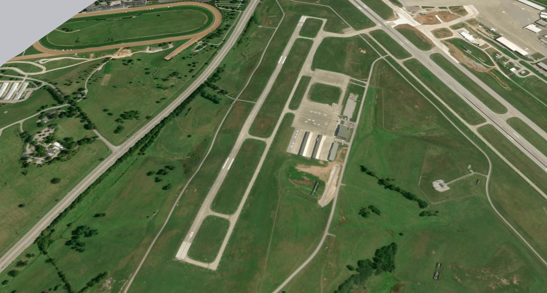

It’s Blue Grass Airport in Lexington, KY. It’s a pretty big airport with 2 Runways and I need the terrain resolution to be pretty good for what I do. So I imported maybe 40 individual screenshots at 18x. So probably the best the terrain is gonna get from importing, yea?
