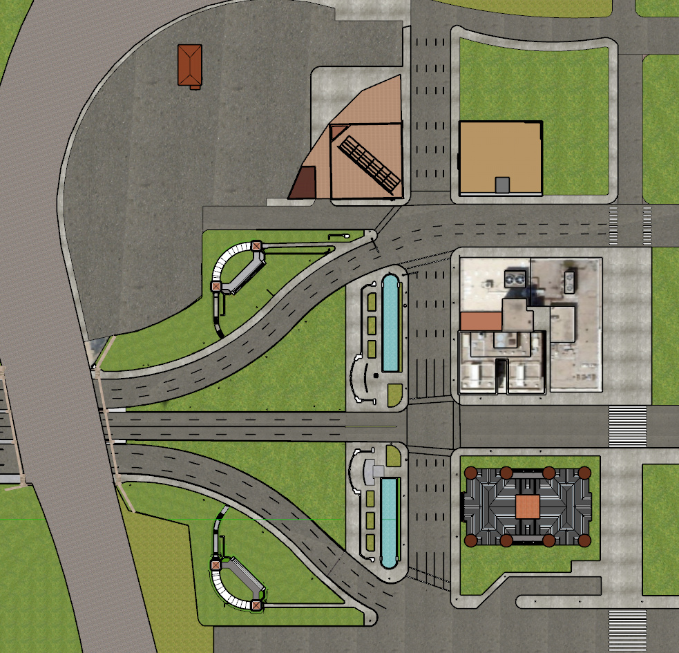

Please notice the web page that I am designing:
Robertson Measurement Tool
It will allow the users to determine by themselves the factibility of (or lack thereof) the infamous Single Bullet Theory/Magic Bullet Theory or SBT/MBT. The user should be allowed to perform zooming with no quality loss and therefore I will be using the SVG format. What you see up there is a mock-up, those files are JPEG taken from my 3ds Max model. However, I decided to use my SketchUp model of Dealey Plaza. See screenshots (still JPEG) below.
How do I extract the views in SVG format? At the minimum I need the 3 isometric/orthogonal views, but some perspective views will be useful as well.
