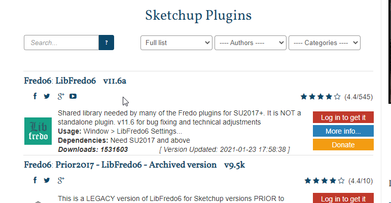

Did you also install LibFredo6? It is required.
from sketchucation plugin store. How and where do I find LibFred6?
Go to the Sketchucation Plugin Store and search for it…
Restart SketchUp after installing.

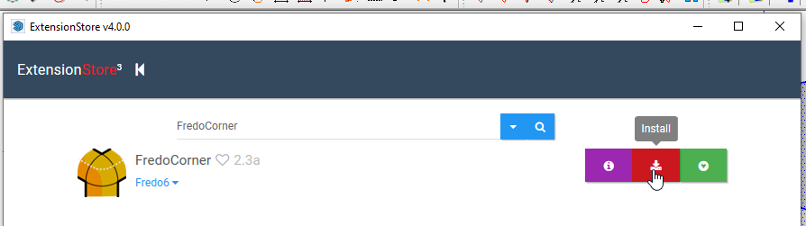

If you are downloading them to your computer to install them, yes. Extensions that come from the Extension Warehouse can be installed through the Extension Warehouse interface in the Window menu. If you install the Sketchucation Extension Store tool you can do a similar thing with extensions from Sketchucation. Search for the extension and click the Install button.
Note that LibFredo6 does NOT need to be installed multiple times. It is a shared component used by @Fredo6 's extensions. If you install more than one of his extensions, LIbFredo6 will only need to be installed once (in order to get the first of his extensions to operate, whichever extension that happens to be). After that, the installed copy of LibFredo6 will be used by all of his other extensions.

Guess Sketchucation Extension Store is another source than Extension Warehouse?
Yes, exactly so. The SketchUcation site predates Trimble’s Extension Warehouse, if I recall correctly.
