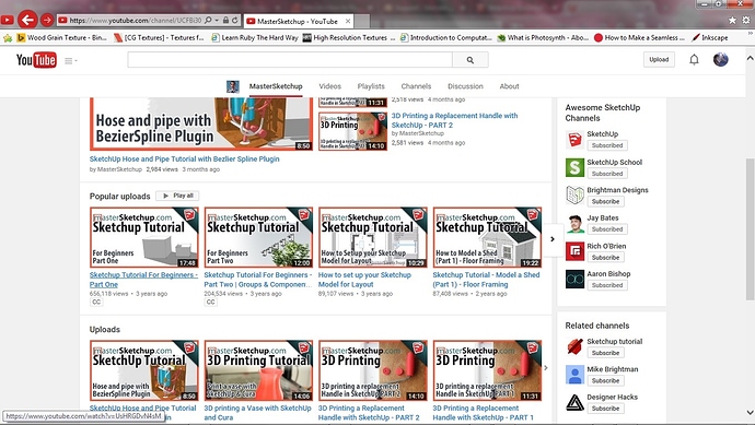

Hello, this may help you move forward: the link will take you to You Tube and start with the for beginners parts 1 and 2. After that he provides a 4 part tutorial for making a shed. Think of it as one room of the house you are working with. More important is that the studs, floor, rafters are just that regardless and will be for anything. The steps will introduce to you HOW to manipulate them with the tools and basics from the first two videos. Build your mind first, as the foundation is the start of any home…Peace…
