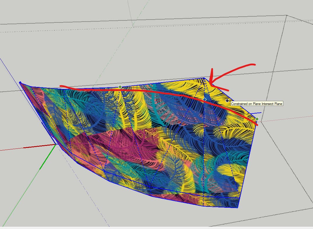

I need to extrude this edge, the wall has to be curved in this part, but the problem is that the wall has a curved format too…so what plugin I can use for this? the file is attached.

It’s not exactly clear what you’re asking for here. The post title says ‘extrude curved faces’ while your post says ‘curved edge’. Here’s how I interpreted it:

Sorry my english, I just want to take off that part you extruded.
how would you do it?
Just extrude the flattened version of your wall (the part you want to remove that is) so that it ‘passes through’ your curved wall. Then select your curved wall face and right-click and choose ‘intersect with model’.
Then erase the top edges and face.
Result (minus the texture so it’s easier to see):
Fredo Joint Push Pull will let you do this
You don’t need Joint PushPull for this now that you clarified what you were originally wanting. If you make a ‘flat’ version of your wall, you can use the regular PushPull tool to extrude the part you want to intersect, and then delete.
