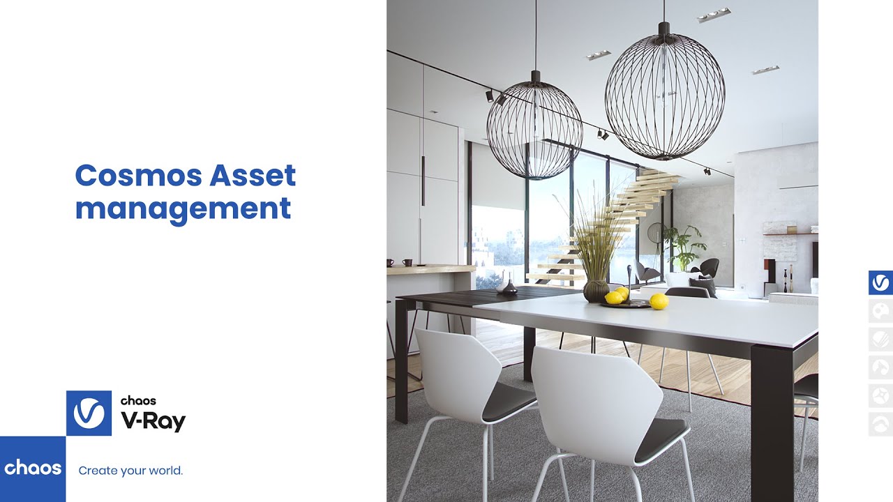

hello, in addition to bmike video, understand that every 3D assets you’ll import from chaos library are proxies. editing them directly in sketchup won’t have any effect on what’s going to be rendered as it will refer to an external vmesh file
That video is not mine, found it using internet search. Lots of options if you search.
This one is one I had bookmarked. It’s older so not sure if it’s 100% workable anymore.
Thank you! It finally worked.
