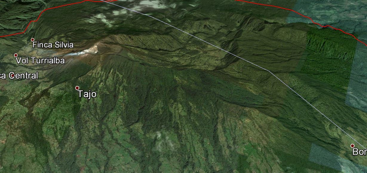

I do hazard research about volcanic buildings, and to do so I use large amounts of data, collecting pictures of the volcano fields, 1 km sq at the time, Tungurahua (Ecuador) Barú (Panamá) take more than 60 pictures, and the capture of it is miserably painful, as you know it’s really hard to place 2 pictures aside, just imagine when you have to place them 20 km away from each other. So, I must admit that is pretty challenging and rewarding, and maybe a cure for alzheimer’s too.
I’m wondering if is it’s possible to capture large areas and how to do it?
Thanks for your help.

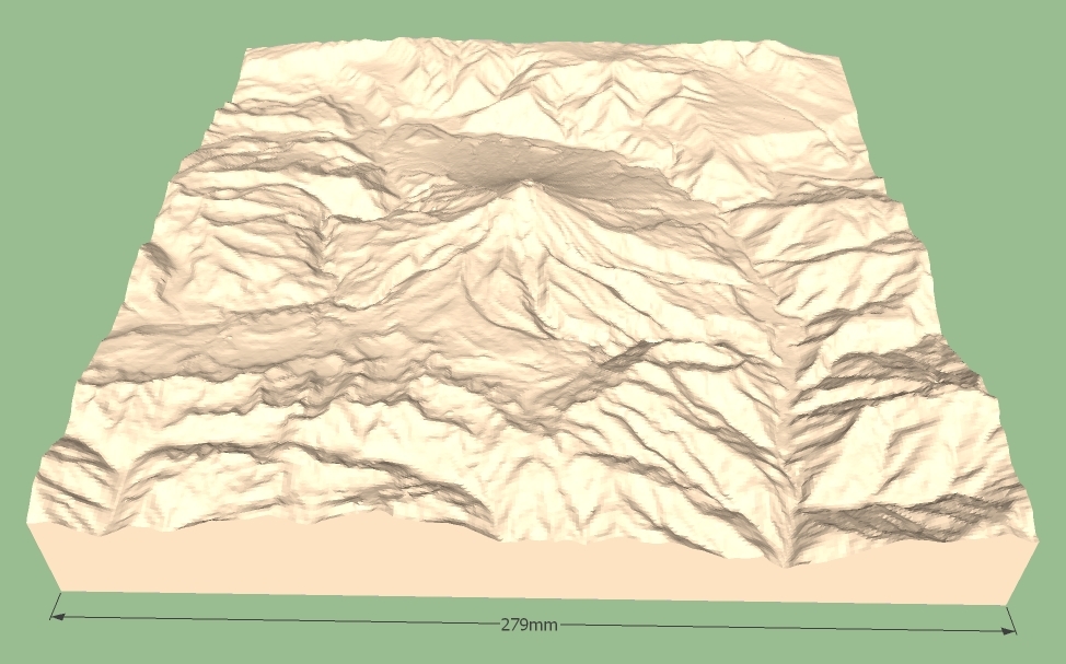

Terrain2STL generates large stl-files which can be imported in SketchUp.
If texture is needed this must be added afterwards.
Tungurahua is in the center.
The file is to large (7700kb) to upload here, but very easy to generate.

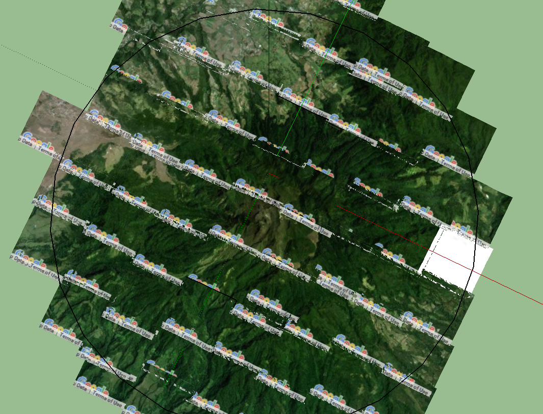

Image wise, you can get fairly high resolution image from google earth pro which is free. I believe larger than 4000 px across per image which you can stitch, but it is larger than what sketchup offers.
From what it looks like, the STL file is generated from google. Third party application using google data are somewhat limited in producing good resolution data compare to their native software google earth.

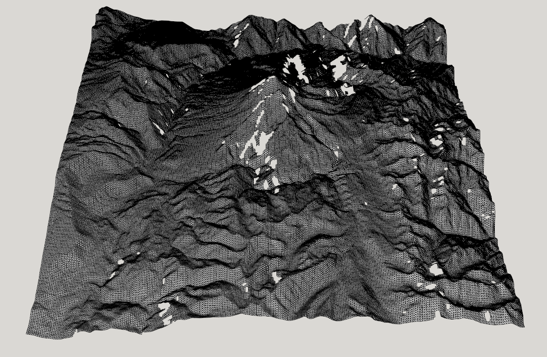

I downloaded the file and imported it directly into SketchUp using a 1-in-8 sampling (150 x 150). The data format reserves -32768 as the indicator that there is no data available for that node, but I had not encountered any of these holes in previous files I’ve imported. However, the data for this area looks like Swiss cheese:
I also imported a 300 x 300 grid roughly centered on the volcano using the maximum resolution of the file (this is the same result you get from using the Terrain2STL website):

Holes can be caused by to little geometry. I wonder why this stl-import is error-free.

Yes, they can. However, the file I downloaded from http://dds.cr.usgs.gov/srtm/version2_1/SRTM3 has raw data containing numerous values that equal -32768 which represent a void (probably caused by water). This has nothing to do with SketchUp.
Because it’s been repaired … I left my import as I found it.

Last year looked the result like this (in netfabb): the red parts are holes. Little holes can be closed by netfabb or meshmixer and so on, but to close a hole where a mountain should be, that was not much funny.

Thank you so much for your advice, I’ll try that! Do you happen to know how to add the real-image texture of the site afterwards? When I open the terrain as a mesh without the Google Earth texture
That’s a very complex subject.
There are several videos on YouTube about that
Google Earth let you capture a wild size images so you just adjust the image to the terrain.
The painful part is that we can avoid the learning curve
Check out YouTube, there are many videos and hopefully you will find one that suits you well
