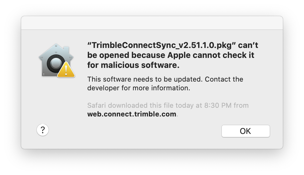

I’ve been looking in on Trimble Connect for years now waiting for it to be ready for prime time. Most of my clients enjoy seeing their model being developed which I share through DropBox or email. Encouraged by this thread, I downloaded the Sync app. Maybe it’s me.
Apple has started to require software developers to ‘notarize’ their installers, part of a wider effort to protect users from malicious software. This has been ratcheting up for the last few years, and with the release of Catalina, Apple now adds some pretty scary sounding language to their dialog. My guess is that the Connect Sync Tool isn’t the only installer you have tried that shows this warning.
I’ll have a chat with the sync tool team to see what their plan is to address this. I can’t make this dialog go away for you, but I will tell you that I saw it myself the other day when I installed a new build of ArchiCAD for some testing. So at least the Connect team are not alone in this. :stuck_out_tongue:
You can still install the app. Here is Apple’s support article, “Safely open apps on your Mac”, explaining the process better than I can.
