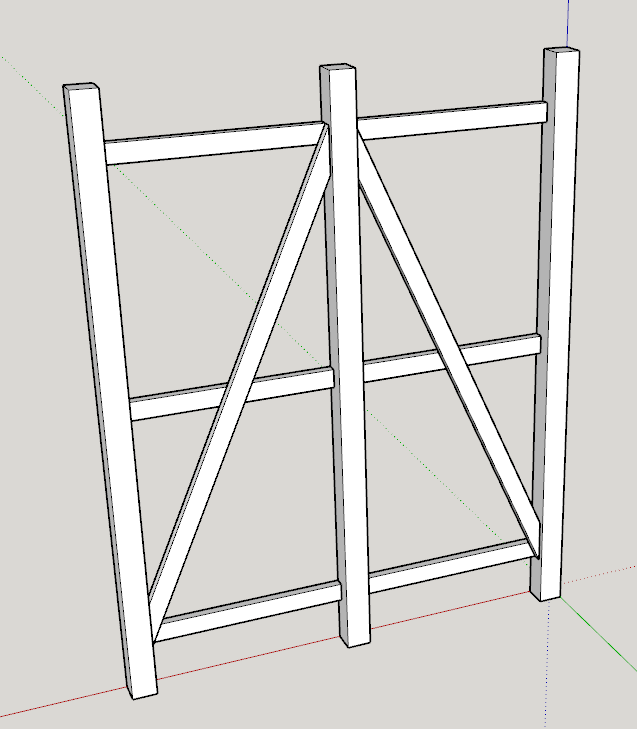

Maybe something like this?

No hole in the middle horizontal. I actually need two braces on each side. Both sides are different dimensions.

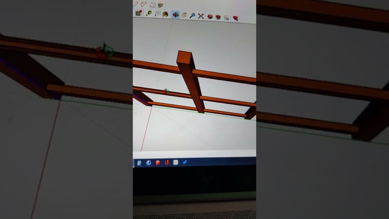

I’ll send you a YouTube video. I hope you can understand my Scottish accent :smiley:

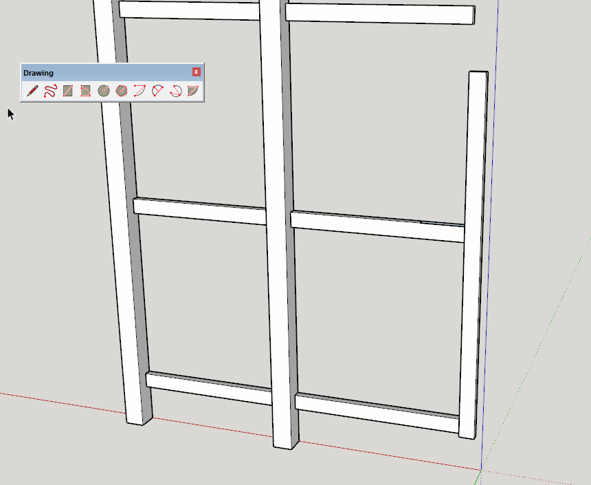

Maybe this will work. I made a component for the diagonal in the vertical orientation and placed it as shown at the beginning. It’s inside the post so I hid the post temporarily. The Pie tool makes it easy to find the point on the edge of the brace and then Rotate to position and trim it off.
brace
OK. So see if you can make heads or tails of my GIF. Once you have one brace on each side you can use Move/Copy to copy them up.
