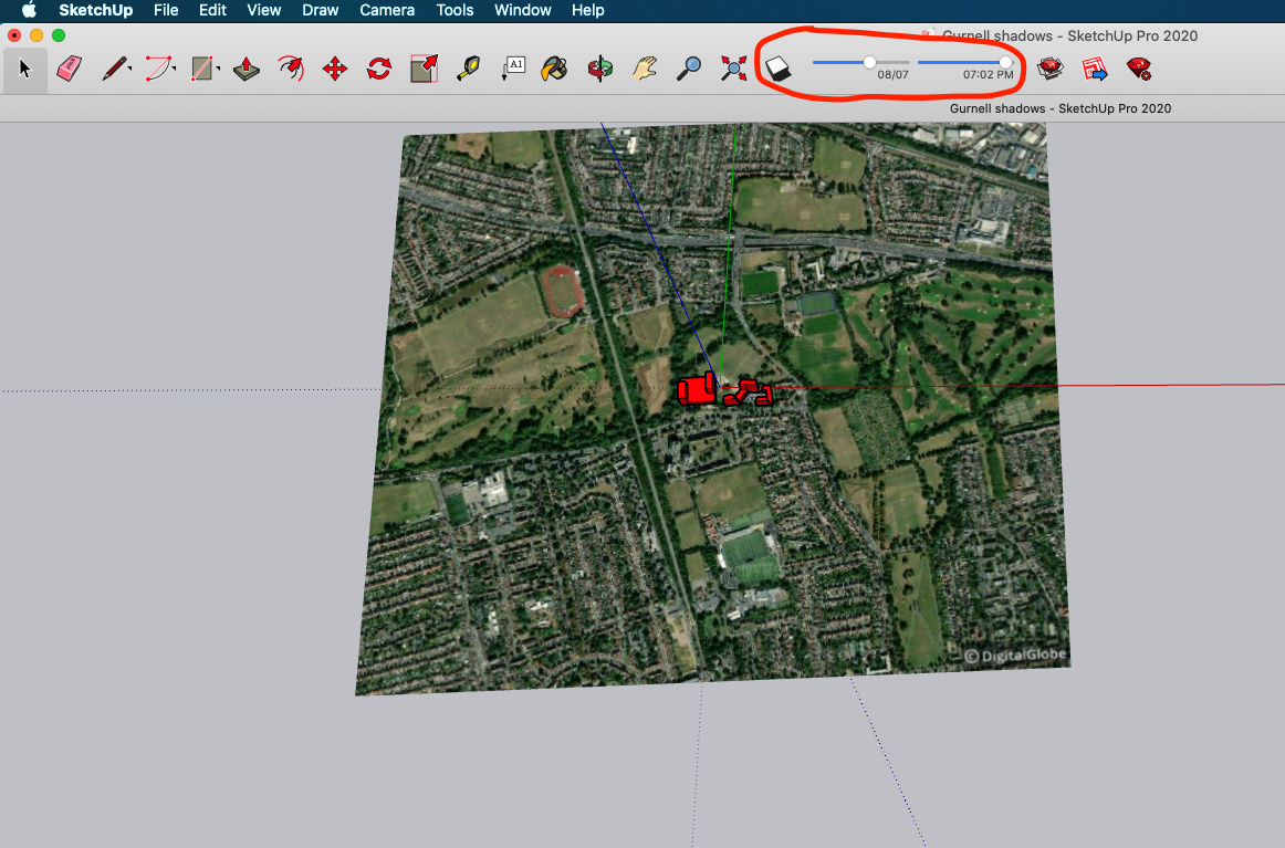

I have the Shadows options on the the top bar however it does not have the dark and light sliders.
I have attached a screenshot. The shadows tools are circled in red.

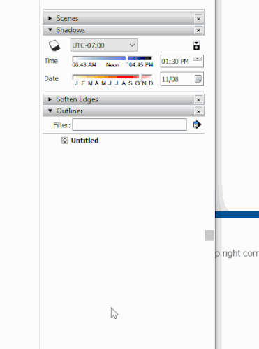

Box has given you the correct answer. Look in the Window menu for Shadows. Since there’s more control over the shadows in the Shadows panel bar, I don’t even bother keeping the Shadows toolbar out. It takes up too much valuable real estate for me.
On the Mac, you can get rid of those sliders in the top toolbar if you right click the toolbar, choose “Customize Toolbar”, and then drag the shadows sliders off the toolbar. You can also drag other tools onto the toolbar from the window that pops up. Unlike on Windows, this is the only customizable native toolbar available.
