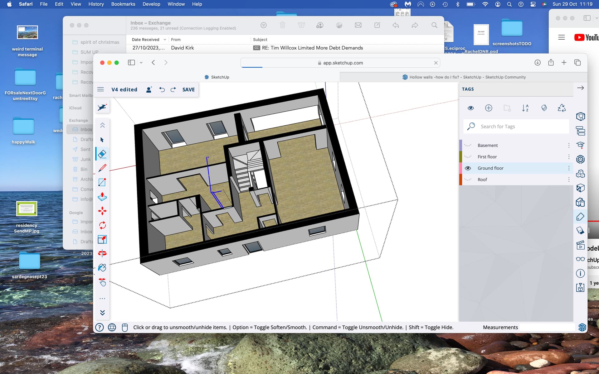

Hi Im new to Sketchup. The tops of my walls are missing. Can anyone advise how I can fix please ( and how I may have los them in the first place?) Thanks[/Users/carolineeves/Desktop/Screenshot 2023-10-26 at 18.12.55.png](https:///Users/carolineeves/Desktop/Screenshot 2023-10-26 at 18.12.55.png)

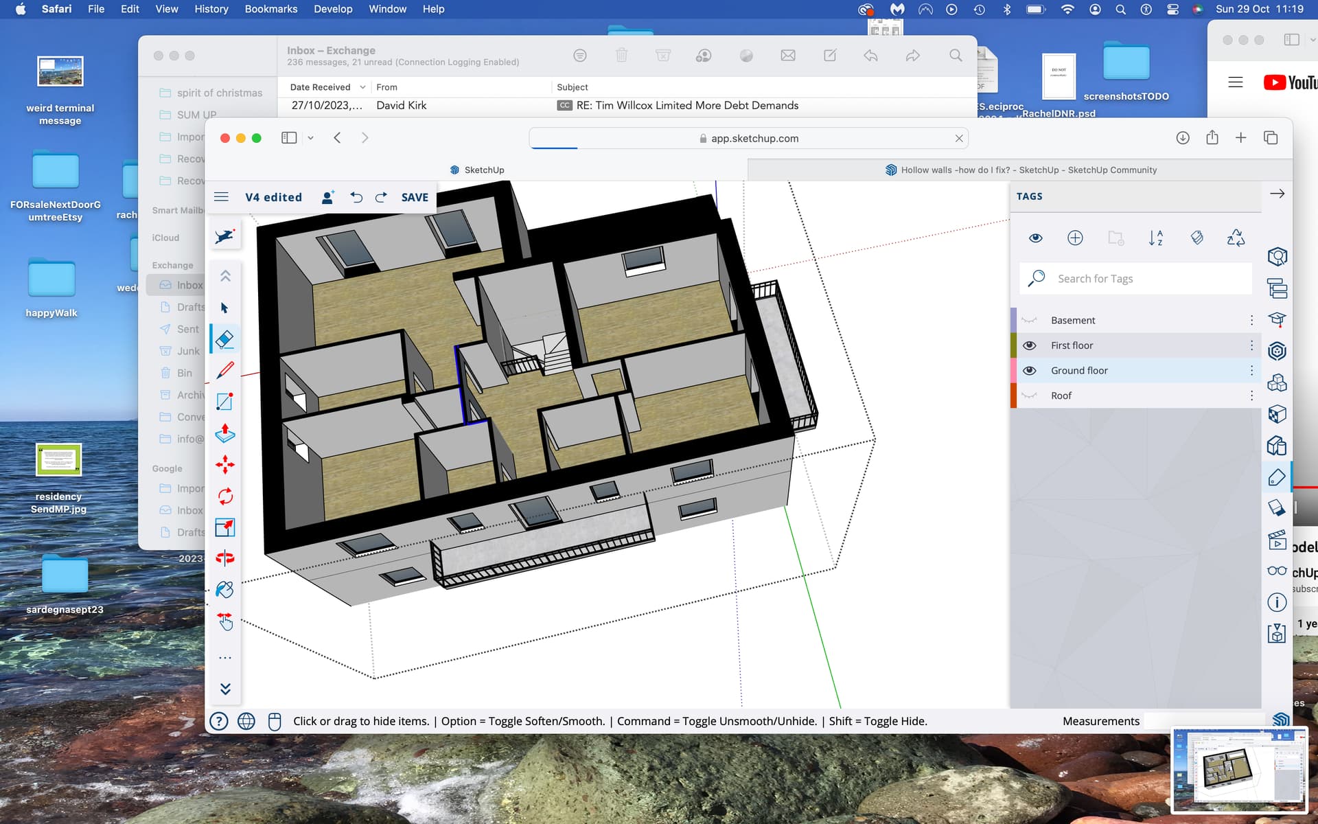

Im having another issue though which I cannot fathom-done know if you might be able help with this one? I have some blue lines which I cannot get rid of > they seem to be ubiquitous ie appear on each tagged section.

I see no blue lines/edges in your uploaded model. Only in your screenshots that appear to be from the model in an earlier stage.
There’s a section cut in play here. Walls aren’t hollow, you’re just seeing the cut plane where it intersects. It cuts away everything and reveals the interior. Just turn it off if you want to see the model without the cutaway.
No section cuts in this model. The tops of the walls are painted black which makes them look like they are a section cut with Section fill.
@timwillcox, I’m not seeing missing faces in your walls. There are some hidden edges, though. I wonder if what you are reporting as hollow is really just the geometry in SketchUp. SketchUp is a face modeler and does not create solid fill. If you delete or hide a face you will see the inside as if it’s hollow but that’s normal.
