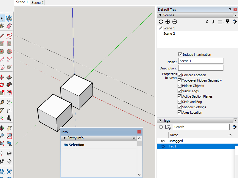

They ARE among the options.
Screenshot - 8_10_2021 , 7_36_51 AM
This is from 2021 which also has Hidden Objects as an option.

But you can assign a different layers to different guides ( points and lines) similar to other drawingelements. Then you can control its visibility with the layers.
Moreover if the guides are part of the a top level geometries (not in a group or component) the scenes can remember if its hidden or not.
The animation made in SU 2021, therefore the Layer is called Tag and Layer0 called as Untagged. Otherwise should be similar in SU2017
hg
Something similar just showing that guides can be on in one and off in the other.
