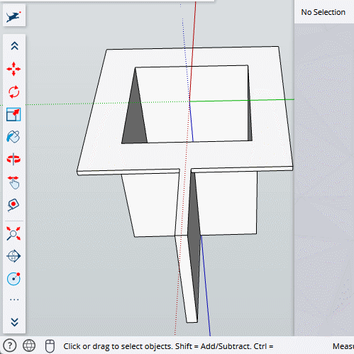

There is a Stray edge inside. You can use a section plane to look inside and fix errors.
GIF 20-03-2024 4-02-11 PM
