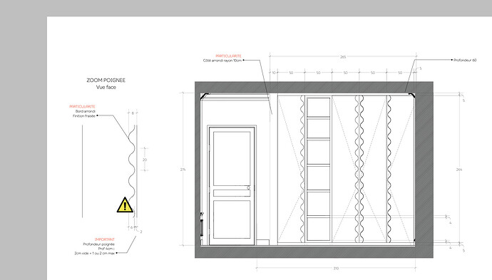

I worked on a 60 pages document and this morning after after opening my file there is several issues: :scream:
  • All is SUPER SLOW (I passed the doc in hybrid format) but still it is normally not that slow ; it takes hours to go slide by slide
  • I cannot refresh the SKP link : when I click on the image which I should be able to refresh, I cannot even access to it : there is not blue frame appearing !!
  • the scenes appear wrongly : 3d captures appears with part of the hidden items :sob:see capture
  • some of the one B&W pages are now colored see captures

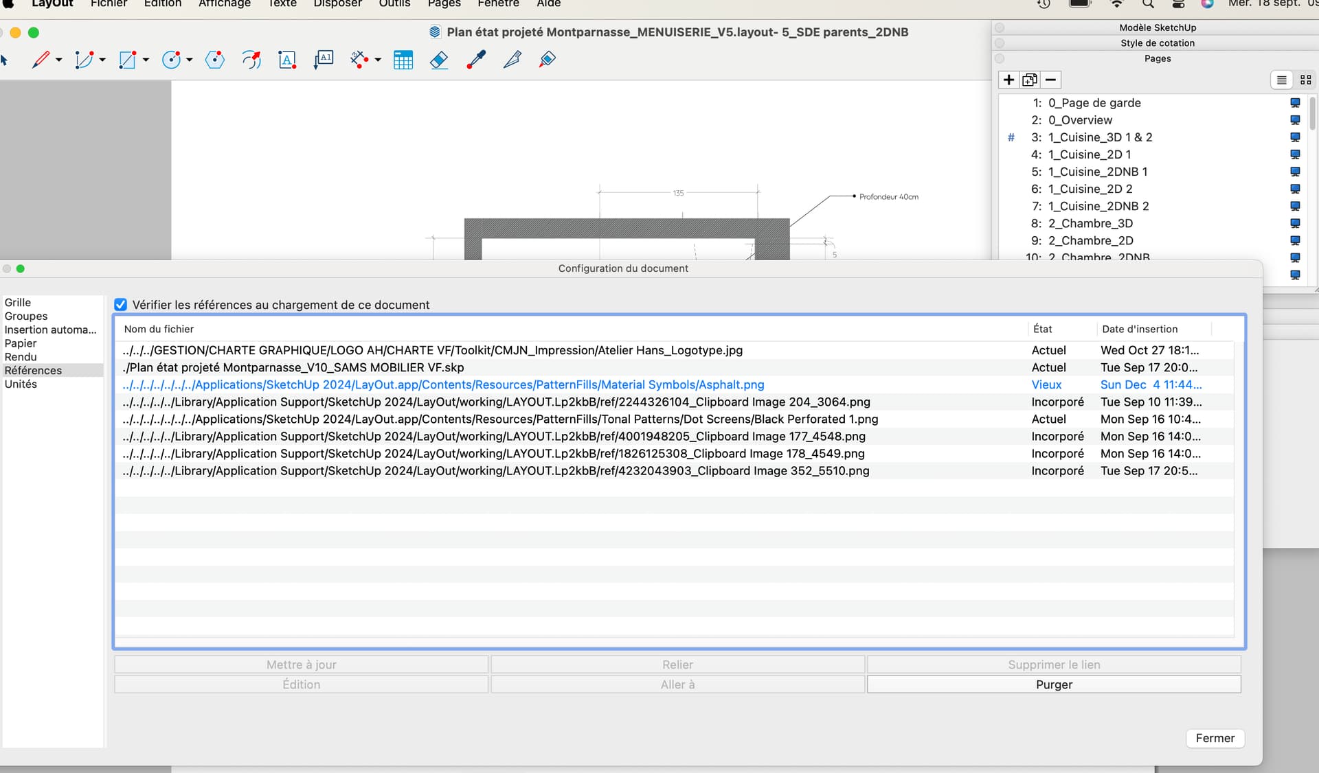

Actually I thought there would be an update but it seems it did not happen over night as I thought ?Processing: Capture d’écran 2024-09-18 à 10.47.32.png

Plus, in the meanwhile, I copied my document, and try to accept to correct the errors (see previous capture). After waiting 20 min, it seamed to have updated almost correctly the document but I had this “WARNING flag” appearing see capture
 I was feeling relieved but then it bugged again
 to the scene issue described in my 1st message !! I don’t understand :confused:

It is a known issue that when you use view clipping instead of a section plane to create, for instance, an interior elevation, things that are “behind the camera” come into view in Vector or Hybrid mode. Another known iddue is that when a model is far from the origin, in Hybrid mode, edges and faces mismatch.
Good points from @ateliernab and @Anssi, and I would only add that we always try to test if the issue is in SketchUp (the Viewer - linked in LayOut) or LayOut itself. If you’re in vector or hybrid in LayOut, take that scene in SketchUp and try exporting a PDF from SketchUp. If it looks bad there, we can file a bug but nothing to help you in the short term. For a quick, better look, about the only thing you can do is to go to the pages that don’t render correctly, change to raster viewports, set your File-Document Setup->Rendering resolutions to High, and see what you get.
