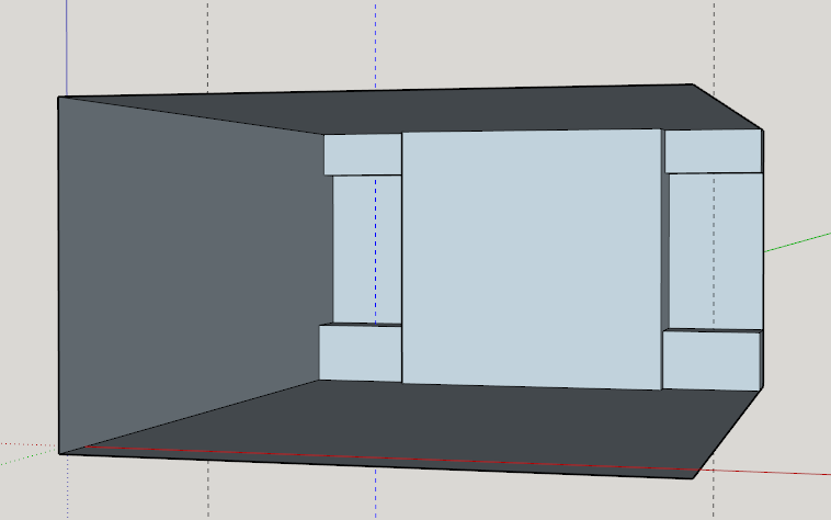

Hello, I am new to Sketchup and am in the process of learning its features. I am on the third tutorial which focuses on designing a room. When I measure guidelines for the first wall, I have absolutely no problem. When I navigate to the adjoining wall and use the tape measure to set up guidelines, the guidelines disappear behind the wall. I can see the guidelines above and below the wall so I know that they’re there - I just can’t see them on the wall. I’ve checked the view box and have done some of the other suggestions without any luck. I’ve also emailed customer support, but I can’t get an answer. I’d appreciate any help with this problem.

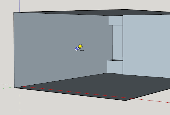

I actually want it on the wall to the left. The dark gray wall. I measure from the edge and can only see the guidelines above and below the wall. Not through it.

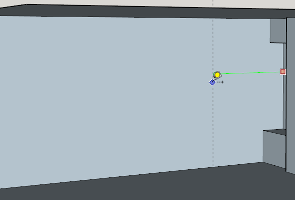

Make sure you are seeing the green line trailing the cursor. As I said you need to get in the habit of orbiting around your model. Sometimes changing the viewpoint makes it easier.

Make sure you are moving the cursor parallel to the green axis. You might find it easier if you orbit the camera so the green axis is going across the screen more.
I measured from the right and they showed up. It’s just something that will take practice. Try moving the camera. Or orbit around to the other side and do it from there. You’ll be able to see the green axis.
You can also start dragging out the guideline and then hit the left cursor key to lock it to the green direction.
