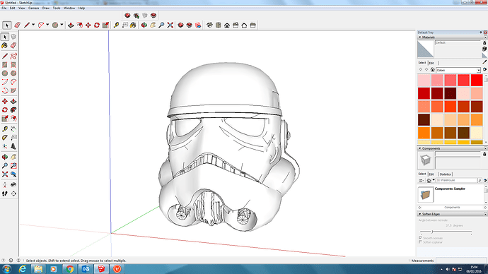

Thanks for all the suggestions and help people, it is for a 8 year old so its not full size. I’m teaching him about 3D printing and he asked for stormtropper helmet (he could of chosen something simpler!) I’ve checked and its within the parameters of the printer and hoping with it being hollow it wont be too expensive
I’ll have a play today
<img src=“//cdck-file-uploads-global.s3.dualstack.us-west-2.amazonaws.com/sketchup/original/2X/1/1f50a38f49078d674407bab5fb45d3d201f9a216.png” width=“690” height="388>
managed to get something that looks like what I’m wanting, now to test
Now hit soften/smooth.
No, not at all. The visual effect of smoothing or softening doesn’t actually affect the underlying geometry. Only how it looks on screen or in renders.
To smooth 3D Printing the geometry itself needs to be smooth.
What you have there looks like it will print quite smooth anyway.
