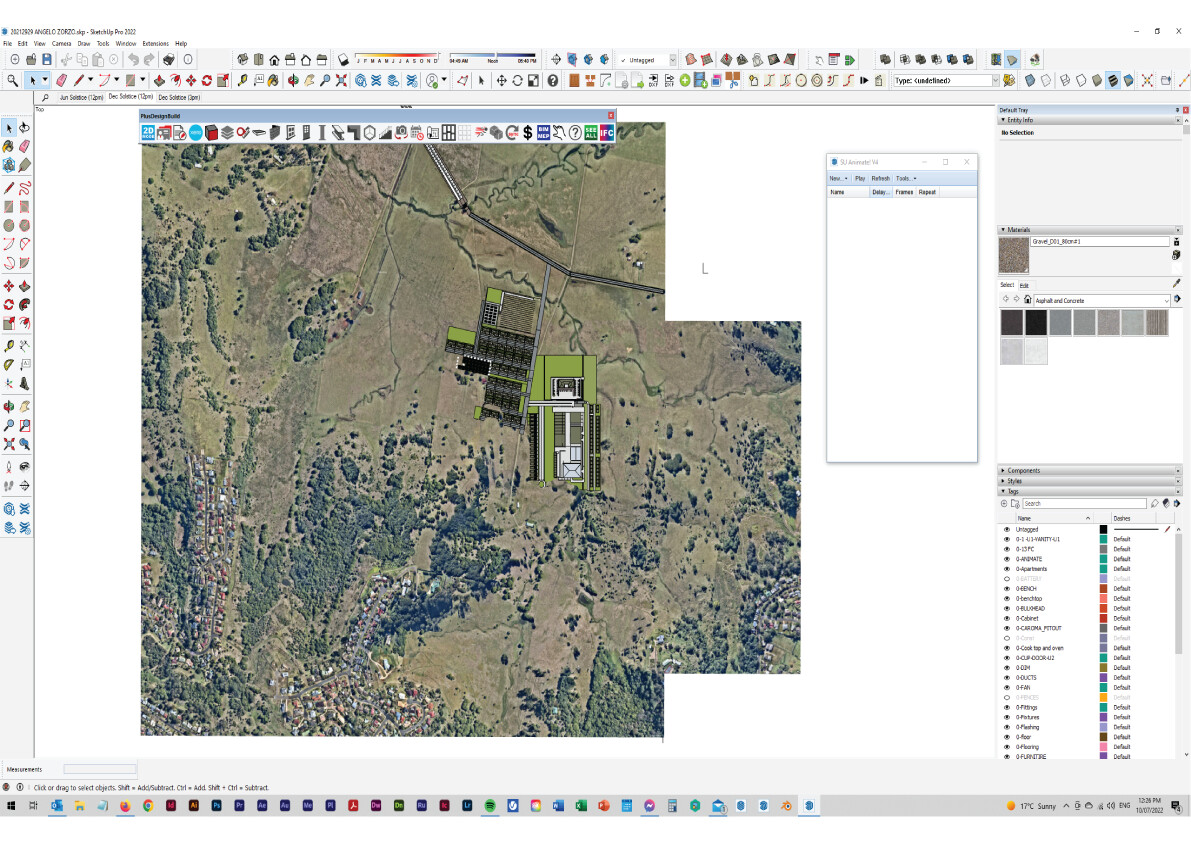

how accurate is the terrain feature in geo location? can it be scaled to provide accurate elevation changes?
I think you’ll find the accuracy to be somewhat variable depending on location. The resolution isn’t especially high, either. The terrain is simply geometry and you could scale it after unlocking the group although that might not be the best option and might not result in accuracy across the site. The Sandbox tools could be used to refine the geometry.
If you need very accurate terrain you would probably do better to get local survey data and generate your own terrain.

Does accuracy Geo Location when I find a benchmark co-ordinance X - Y - Z mm accuracy for Lismore NSW.
