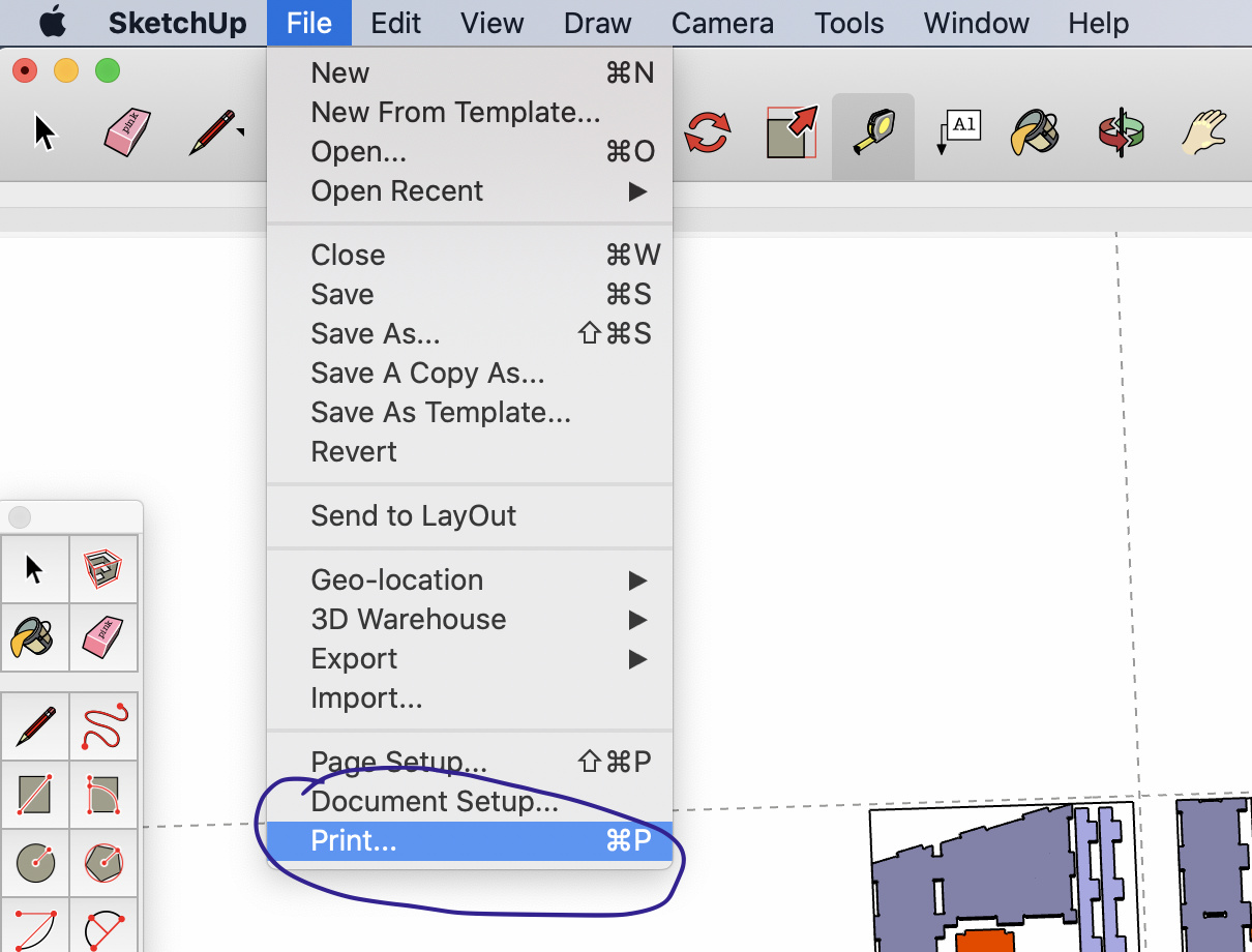

I am using MAC version of SKP and I can’t seems to find Generate Report in Sketch 2020. I did use it in the past in 2018. Did they rename it or place it somewhere else?
In 2018 it used to be in File → Generate Report.

You are spot on. I disabled all plugins and forgot to turn it back on. Also now I did a test again with disable all and it did not affect. It seems like a bug somewhere.
thank you so much for your help.

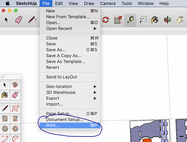

Thanks for your reply. Just got online now. It seems like you were on the right path. See my screenshot again after I enabled all plugins again. It fixed it.
