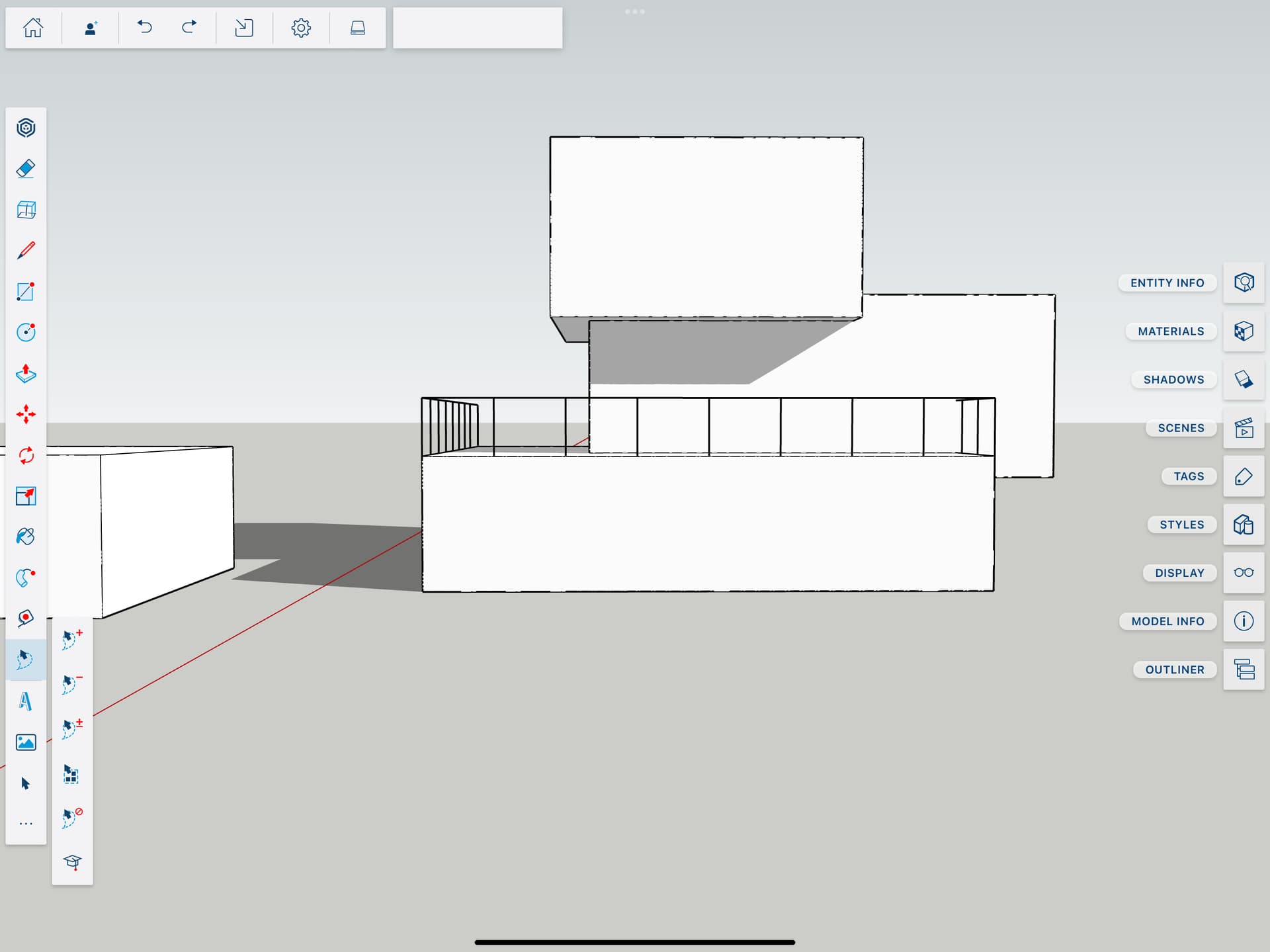

Reporting something I came across today with the latest build (6.1.0 (172)) While orbiting, as the model edges approach parallel to viewer they become pixelated and fuzzy. I am on an iPad Pro 12.9 4th generation (non M1 chip).

I closed the app and open the file again just for kicks. Same fuzzy line issue. Pretty nasty looking.
Try going more parallel to the viewer on this view if you don’t mind… i do see pixelation in the lines here as well, could be my old eyes…

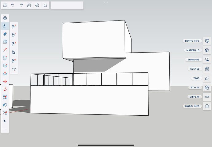

I’m not seeing it to the same degree as your screenshots show. It is just gpu artifact, though.
This is how it looks on mine. ’
Yup. There is a bit of antialiasing artifacts there also. Albeit not as bad as mine.

I think that’s going to take a GPU or GPU driver update. Not something that SketchUp could change. I don’t see the same AA issues on my new iPad or on my PC.
I have a new iPad Pro M1 and we certainly see it on my screen shot. Not as bad as OP’s screen shot. I also see it a bit on my RTX based PC. I also agree on it being just a cosmetic issue. I’ll try it tonight on my older home PC that isn’t pushing a 38" 4K screen

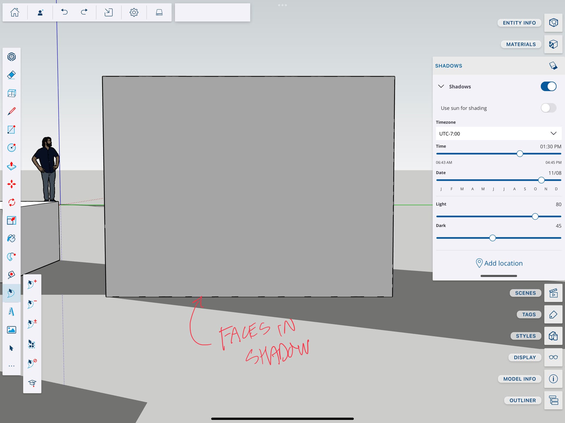

Adding more detail here, and rolling forward to 6.1.0 Beta images below.
Faces in shadow with shadows off.
Shadows On
Untitled 6.skp (115.5 KB)
