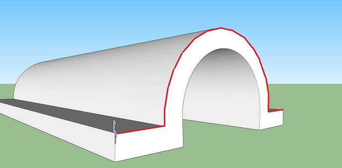

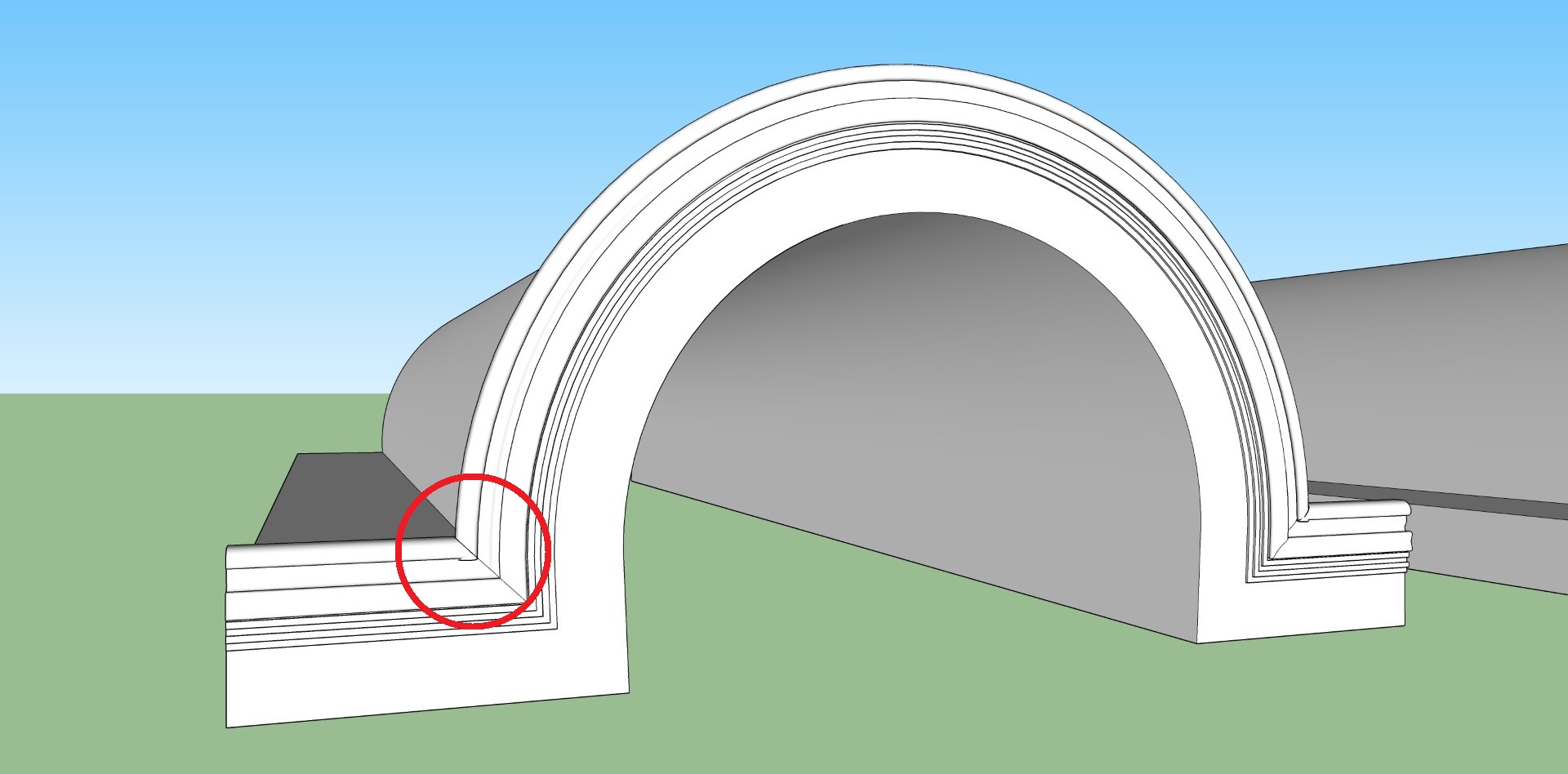

Hello everyone.
I want to draw profile with follow me but I receive the wrong model As a result ![]()
it’s a very easy example:
also uploaded the example model:
test.skp (777.6 KB)
what can i do for resolving this problem?
thanks in advance

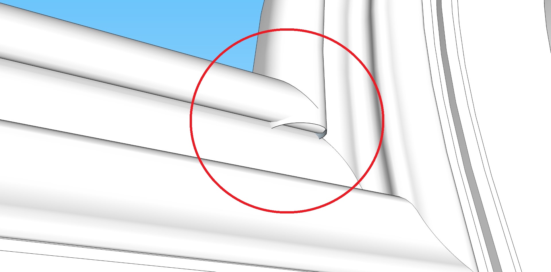

The root of the problem is the location of the path in relation to the extrusion profile.
Use the Offset tool to create a path located at the top of the profile.
Then the profile will extrude cleanly around the acute angle.
See the attached model.
test_Proper Path.skp (1.5 MB)
