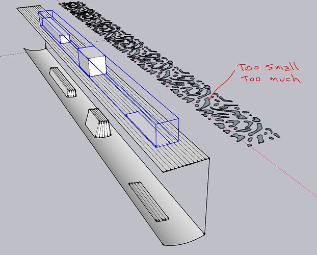

Follow the tutorials carefully and create the necessary groups correctly. Same with the geometry. Read the description.
grp-02
Regarding the model you are trying to apply, it contains far too much geometry and very small dimensions.
Better apply a texture instead of all that geometry.
