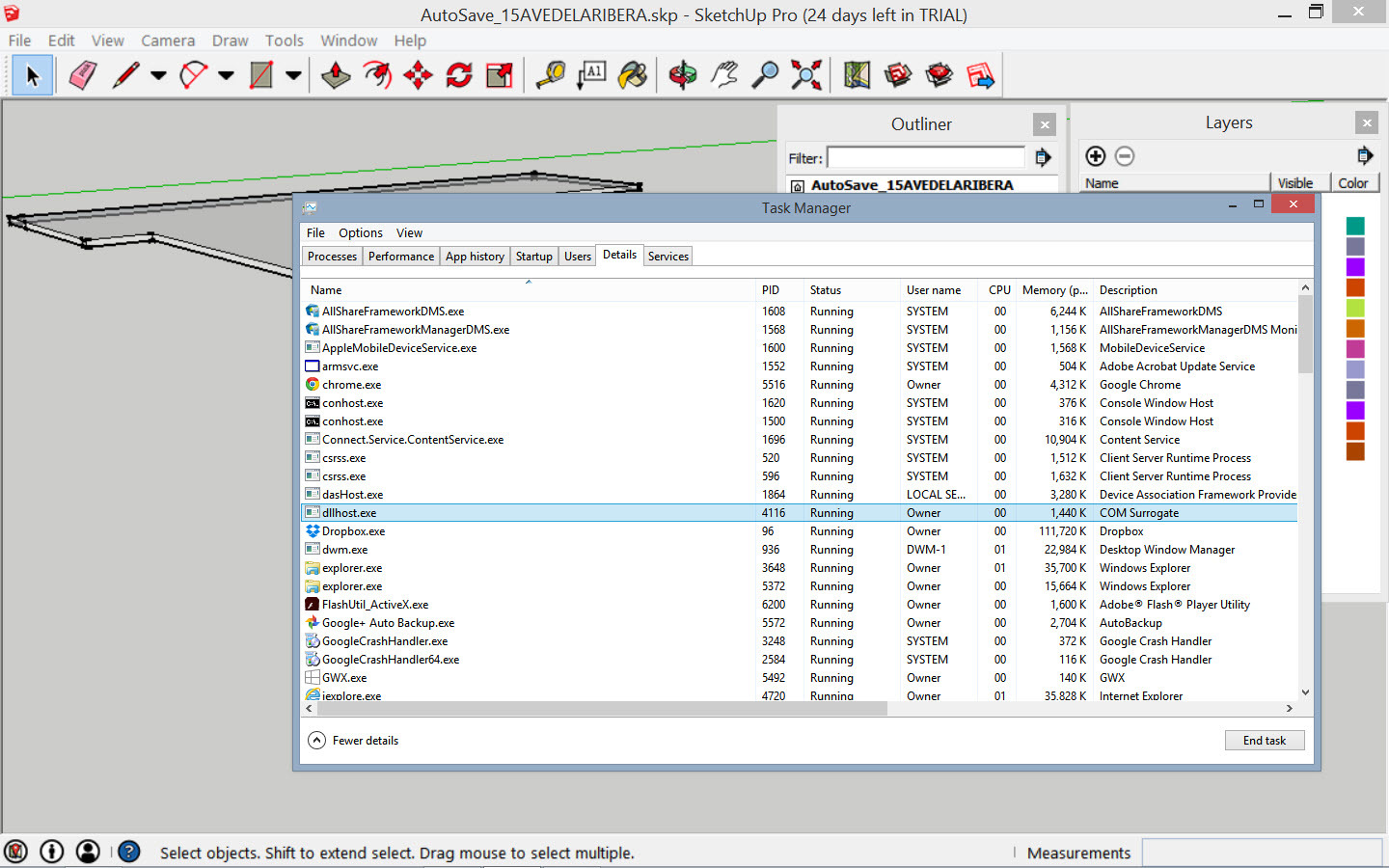

COM-Surrogate in Task-Manager after opening the .SKB/backup file.

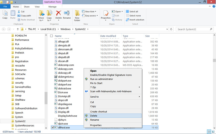

Right clicked COM-Surrogate and clicked details to get this.
I’m not going to delete it as it maybe a licensing thing on the 30 day trial. I believe it occurred when I changed the Win 8.1 system mouse settings from single click to open to double click to open and slowed the mouse action down as it was definitely messing with SketchUp performance. I believe that there where two instances of the model opened or two instances of SketchUp running and that caused the ERROR shown. Could be wrong though. I’ll find out latter. If anybody knows about this subject for sure. Please let everyone know.
I’m not deleting the COM-Surrogate DHL file yet.
Llynrice, Check my post bellow. you have the same system as mine and the preview pain should be set to Extra large icons not details?
Only delete the dllhost.exe (in details) that shows your username; the others are systems apps.
dllhost.exe is a system file and should not actually be deleted from the “Windows/System32” directory.
The word used should be “end task” not “delete” !
