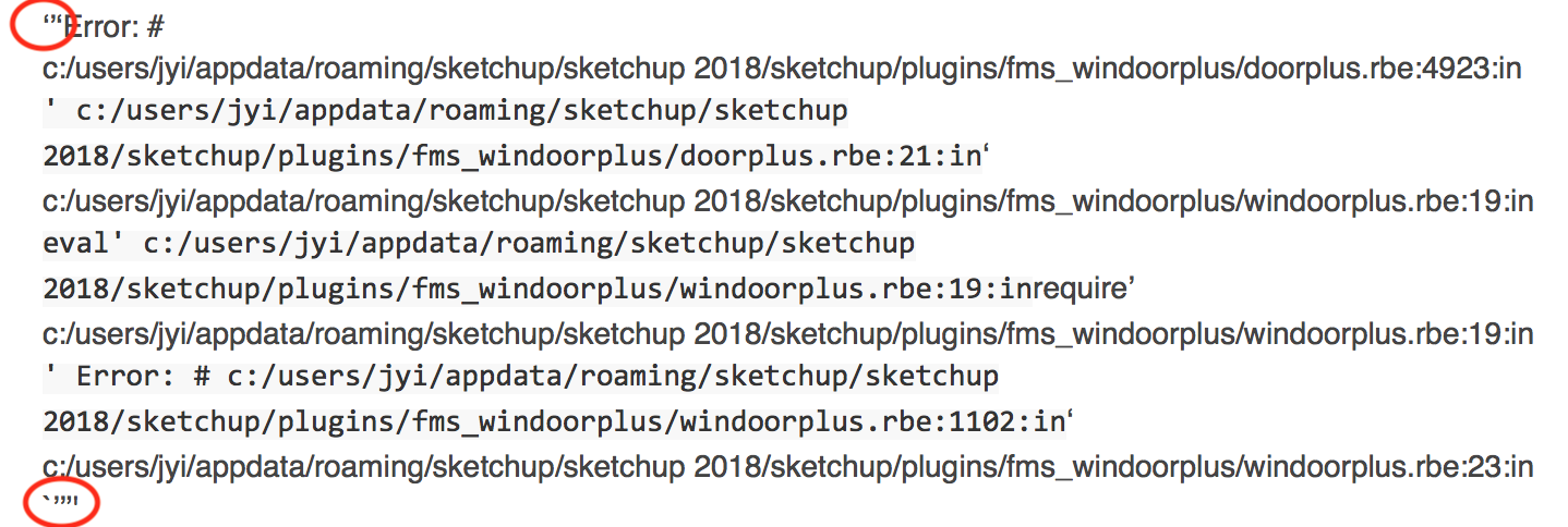

I can’t help with your EW review issue as such, but for future reference when you post something such as the error message you got, please put three backtick characters (` - the one usually at upper left on the key with ~) on the lines immediately before and after the error message. This prevents the forum’s display formatter from interpreting the message as Markdown code and messing it up during presentation. For example, in your post presumably there was an actual error message enclosed in < and > but the formatter took that to be a Markdown tag it couldn’t understand and ignored it.

I added the three back ticks at the start and end of the error message. Hoping this makes it more readable.
Thank you.
It’s now displaying like this, which says either you didn’t put the three backticks on a separate line before and after, or you used some other character not a backtick.
I’m in Ireland, using an English United Kingdom keyboard. I used the tick under the @ symbol.
The one you want is under the ESC key, left of 1.
on my GB/UK keyboard the backtick/tilde key is between the Shift and Z keys …
john
Another tip: in the forum’s edit window there is an entry pane to the left and a preview pane to the right. In the preview you can see the way that the forum’s formatter will present whatever you have typed.
That’s where it is on my UK Mac keyboard too, but @Camlaman is on Windows.
I’m not running Windows nor on a GB keyboard, but looking it up on Wikipedia, it seems like this is the key?
