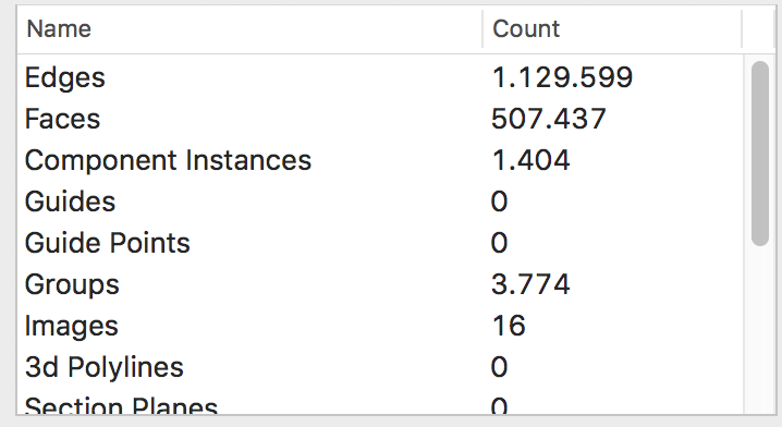

Thanks for your reply! This is a screenshot.
In this model, I used a lot of glass material, but in other models I used a lot less glass. The trees are meshes of Laubwerk. As you can see I use a lot of different materials, some with displacement maps, but mostly without displacement.

300MB seems very large for a Sketchup file with the statistics you show.
I’ve been working on (parts) of a 300MB file, which in full has tens of millions of edges, tens of thousands of component instances, and quite a lot of different textures and images, some quite large.
I don’t really understand why your file is so big.
Do you have very large images and/or high density textures? I can’t otherwise see where the MB could be coming from.

@john_mcclenahan: I use multiple large textures (6k/ 8k), also with different maps like reflection.
That of itself wouldn’t account for hundreds of MB of file size, looking at your image. You don’t seem to have room for thousands of replications of the images.
