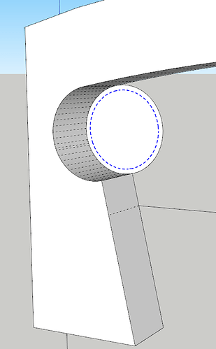

I noticed on this model that the circles cannot be extruded because they are “smoothed”. Did you do this or is this some other error. I generally use hide instead of smooth as it also has caused some problems

Miller softened the concentric circle on the face of the circles. While it looks like one faces, it is multiple faces. Deleting the softened edge or unsoftening it would make it possible to extrude those faces.Actually, even showing them with View>Hidden Geometry would allow you to extrude them separately. Hiding the edge of the inner circle would allow the faces to be extruded, too.
It’s poor practice to soften edges between coplanar faces as Miller has done. If the edges aren’t needed in the first place, they should be deleted. If they are needed, they should be left visible. Softening them in this case created confusion and delay.

I’m not sure why the edges of those circles got exploded but at some point before you extruded the hole and recess they did which makes the vertical edges between faces show.

I “smoothed” the circles “by accident” - but it´s absolutely unimportant.

Smoothed lines can be made visible again with the same native tool one smoothed it.

In the case of the model at hand, you can also just soften the vertical edges around the hole and recess. There are other edges that could be softened so select all of the geometry, right click and choose Soften/Smooth. That should take care of those edges.
Thanks Dave. Last question. If edges are smoothed does not SU then refuse to extrude?
There is a little known plugin that restores Circles and Arcs to their original state rather than just Curve, can’t think of the name of it off the top of my head, have it as a key shortcut. I’ll look it up when near a computer.
Yes because the faces are treated as a single surface and Push/Pull will only extrude a single face in one go. When soften is used correctly the faces aren’t coplanar. Soften would be so that the collection of faces look like a curved surface. Think of drawing a circle and pulling it into a cylinder. Those vertical edges between vertices are softened.
If you display the softened edges with View>Hidden Geometry, the individual faces are shown and treated as such. You can then extrude them but only one at a time. There is the Joint Push/Pull extension that can be used to extrude multiple faces in one go but it’s not really applicable in this case.
There is no reason to soften edges between coplanar faces as Miller did in his model. If they aren’t needed, they should be deleted.

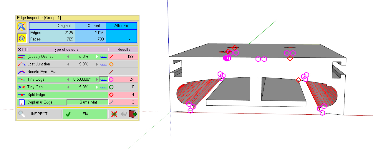

Finding with visual is a mater or size and complexity so one can not take a simple trival case aka the sick file and then say approach is good for all cases. It you delete coplanar edges in that model is quick to see what is wrong.
The jpg is of the z model and using Fredo’s edge inspector. I tried no optimization at all and make no claim if this model is acceptable. The only point is one cannot make flat statement they can correct models in short time with just visual look at it. There are many other defects shown also I did not select inspect for all cases
The finding of issue is just the start of the corrections. Some are not independent meaning the sequence of correction can affect the final out come so, if there no reasonable way to make the the number of trails can get very large and time consuming if done manually.
