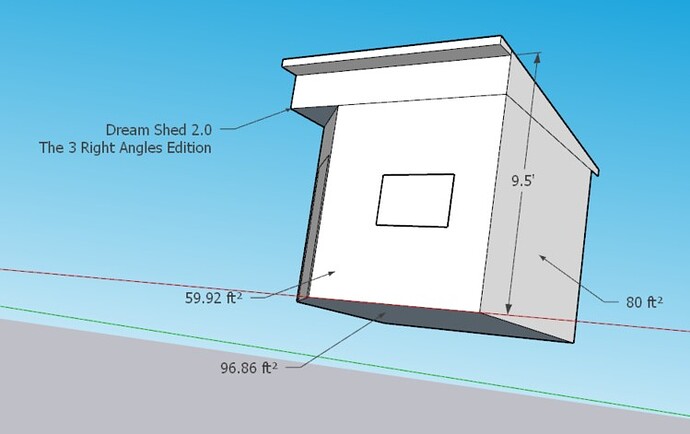

One of the main challenges is the calculation of square footage. Does Sketchup have a running total field that indicates sq ft as I move lines? The shed I will build is not symmetrical and there are only three right angles. I am looking for software that allows me to tweak lines and visualize a running total of square footage concurrently.

In SketchUp you can draw an outline that relates to the area for the shed. In your model this might be the total face of the plywood (for example) that covers the floor to the edges that you would be measuring your area from. When you draw the edges completely enclosing a space on a plane, SketchUp creates a face. Selecting the face will show an area in the Entity Window. So changing the design will change what you read on such a face. It may be best to simply use such an outline for your initial layout and finding the square foot area to go forward with, and if you reshape it, the area displayed will change. It’s not a continuous display. You change the shape by moving the edges and then select the face to read the area.
Your profile indicates you are using the free web version of SketchUp so Entity Info as @pbacot indicated will allow you to see the area of a face or faces. There are some tools available for SketchUp Pro that can make what you are asking easier.
With the available options in SketchUp Free I would probably do as Peter suggested and start with a simple outline. If there are certain dimensions that are fixed, I might divide the face into smaller regions so I can more easily limit what gets changed.

Here is screen capture of some SF using basic SketchUp tools.
(Okay, maybe more than 3.)
Others have pointed to possibilities, but you might ask yourself whether you want to take the time to learn these things. For example, by “200 sq ft”, do you mean the interior sq ft of the flooring? Do you mean the building (shed) ‘footprint’? Do you mean the sq ft of sheathing for the/or a wall? All of those are possible. But do you want to do takeoffs or make cut lists? For takeoffs you may need to learn to make dynamic components and the generate reports feature and for cut lists you may want to learn how to use other extensions. I’m getting off into the weeds here so to get back to focus: do you want to spend more time learning to use SU than it would take you do simply draw these things on paper and use a calculator?!? People here might help you - especially if you went to the learning center and followed the tutorials: [SketchUp Campus](https://learn.sketchup.com/
I found the area tool you mentioned (Sketchandcalc). SketchUp can basically do that - but you’d have to learn how. Maybe that software is all you need.

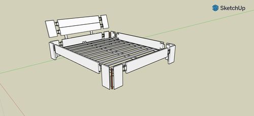

In my case, I often combine. As I’m getting betyer and more efficient I’m using sketchup to verify and make detailed plans for my design. But it takes a lot of time, and often I would jabe build the whole thing ss fast or faster then just making the drawings.
But when you habe done it a lot it will of course be bith fast and easy to verify your designs using sketchup.
This is my current project. As a newbee it takes a lot of time to get these models right:
